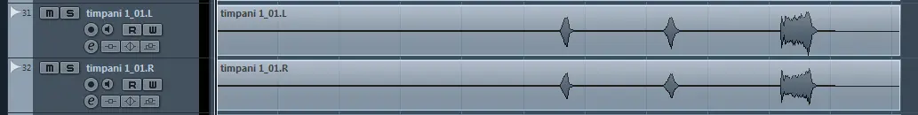

Look closely at the screenshot, so look the files sent to me from the studio after recording.
I understand that this is a mono track.
What do you think is better to send to the studio to mix, stereo, or to divide it into mono.
Different tasks -- If you're sending in tracks for mixing, the studio is counting stereo tracks as two individual tracks. For mastering, it's (almost universally) expected to be working from a stereo track (count it as two mono tracks if you want, but I don't know anyone who charges differently for stereo or dual mono).
Mixing, they're socking for setup, keeping in mind the CPU load, etc., etc., etc. 10 stereo tracks is exactly the same as 20 mono tracks as far as resources are concerned.
Now if you're getting tracks from someone that are stereo with a mono source, that's another story. A senseless and mysterious one. Or if Cubase is treating a mono source as a stereo source (which is possible I'm sure), that's yet another.
If that (above) is a mono track, I can't tell by looking at it. Actually, if I look closely, the waveforms don't look identical. If you invert one and it cancels out, it's mono. Just send one. If there is side information and you want to keep it, send the stereo file.

It doesn't matter! Some strings source, samples and synths have a stereo output, panned left to right like a real orchestra, so that stem will be stereo. A single voice would usually be a single mono track, but if these were recorded in cubase (or the others) it's often simpler to record them all on the same format, and you get a 'stereo' track that is really two identical mono tracks in one wrapper. I don't really care, cubase treats them exactly the same in the mixer, apart from pan becoming a balance control, which works the same in use. The only time I convert stereo tracks like this to mono, or deliberately record them as mono is for file size reasons, so if I have twenty stereo tracks containing duplicated mono sources, it takes twice as long to upload to a client, so even with fibre internet, sometimes it's worth doing. If you have the files, then it really doesn't matter. Cubase will convert them if it makes you happy. I wouldn't bother!
