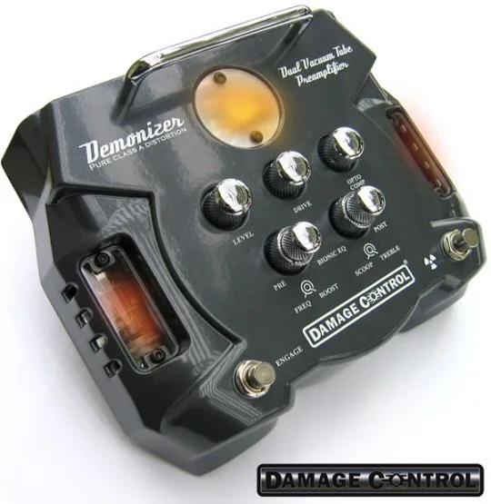

GREAT explanation....and GREAT mics. I'm 'enjoying' mine ALOT!
...though, I bit OT, but in reference to the above statement on petals, with transistors, etc..
..I just got this 'preamp' in (as it's a bit MUCH to be called a pedal), but it has two 12AX7 (and NOT at a starving plate, but 250v!) along with a opto compressor, pre and post EQ, DI out, etc....this thing is AMAZING! It's NOT exactly cheap, but worth at least twice the price....and NO, I have NOTHING to do with them, etc.
http://www.damagecontrolusa.com/dmz.htm
