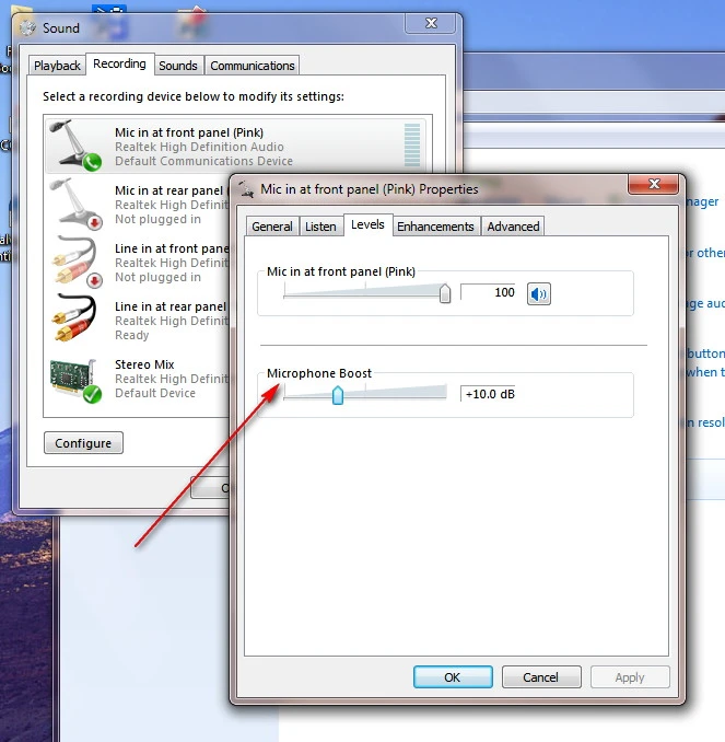

See if you have a setting in the Windows Control panel called 'Microphone Boost'. It might show up in the RealTek audio software also. Below is a screenshot in Win7. Win10 may be a bit different(?)
What levels are you seeing on the meters in your DAW recording software?
Mic Boost is on +30, the meters look good too.
At what levels are the meters getting to in dB? In the range of -16 to -12? If you're about there's likely nothing wrong with the mic.
