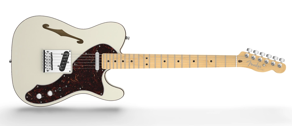

I do need to play a whole bunch of the variants of thinline and solid, which is my next move. I'm going to play one like the picture I added below over the next couple of days and try a number of others at the same venue.
it looks like there are very few options if you want single coils w thinline
i would have to opt for the squier
Squier Classic Vibe Telecaster Thinline Electric Guitar Natural | Musician's Friend
because the other choice
Fender American Deluxe Telecaster Thinline | Musician's Friend
is 1800 buks

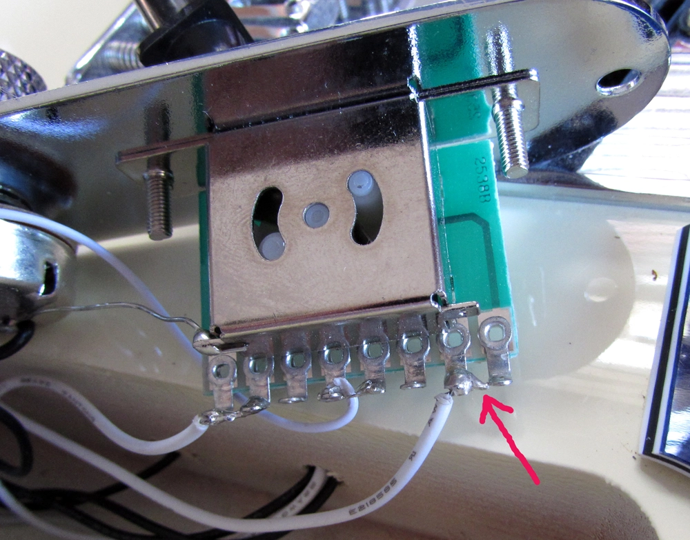

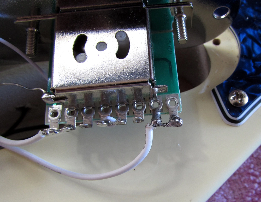

The Squier had an intermittent output from the bridge pickup only when selected on its own. Turned out to be a poorly soldered connection to the selector switch. Two posts on the switch were supposed to be linked together, but the wire had not been positioned well to securely bridge the the two posts.
I de-soldered it and secured the wire before re-soldering, it's fine now.

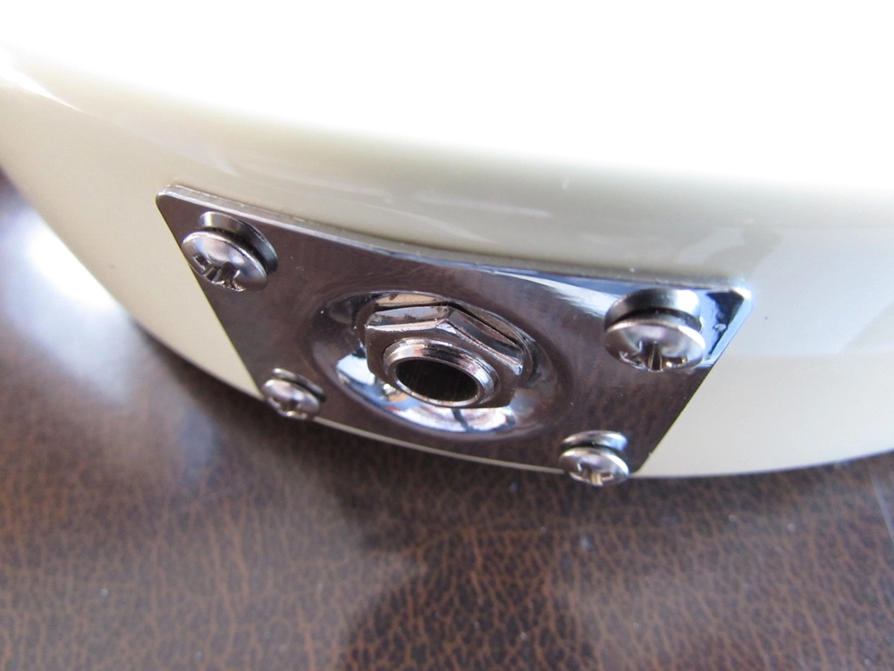

Looking closely it gradually becomes clear that the cheap squier is put together in a real hurry and little attention has been paid to matching screw head dimensions to countersunk holes in the metal plates on this guitar. None of the screws are put in straight either, which is a shame as the actual components seem to be reasonably well made.

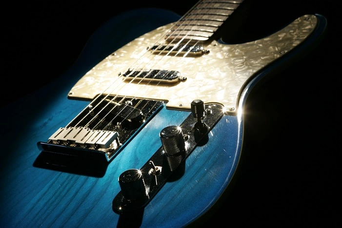

This is my Tele Plus........Fender issued two different p/u configurations, one is in previous pics, this is the other.
Now THAT would be something to try out for variety.
Looks like a tele neck in the middle, insted of the usual Nashville strat middle.
And damn, that is a beautiful guitar! If the color that's showing up on the monitor is true to the actual color of the gutar, I WANT THAT!
Seriously, if you ever decide to sell that, pm me. I'm sure shipping would be an arm and a leg, but that is gorgeous!

Thanks ausrock, as notCardio, says that's a great looking instrument with a configuration that's certainly worth looking into. Thanks for posting, much appreciated.

Firstly, the Tele will never be for sale ;). I can't remember which lace sensors were where but I think the middle and neck were the same.

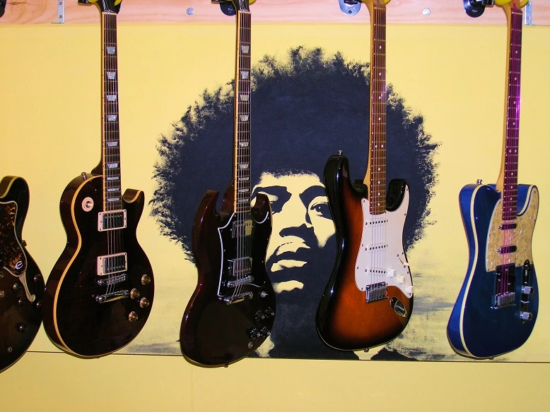

This pic shows more of the body shape, the strings are DR's coated hot pink ......P8140006.webp
Nice selection of instruments. I've got one guitar strung with DR's they actually sound remarkably sweet, just annoying that the coating chips when playing with a bit of gusto. The Hendrix mural is a great backdrop.
