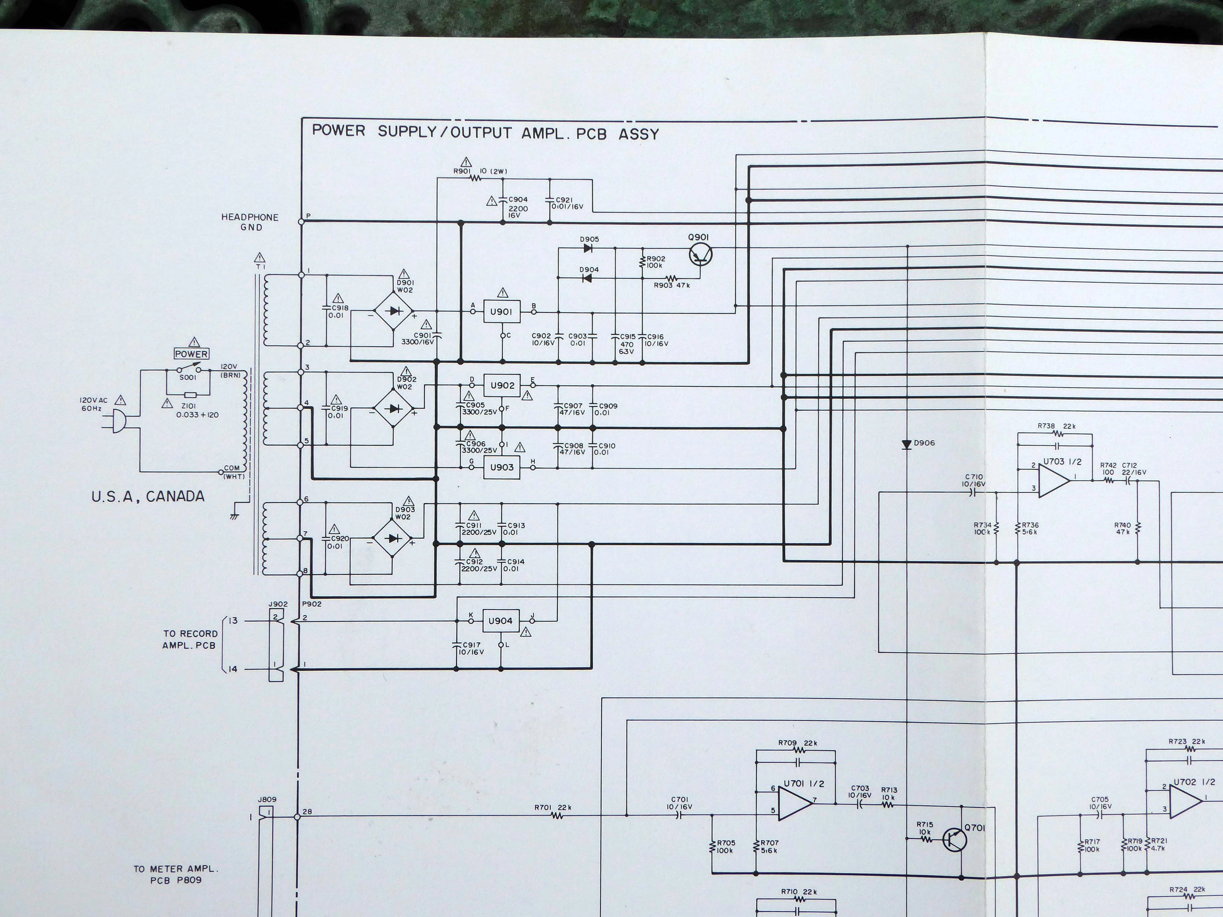

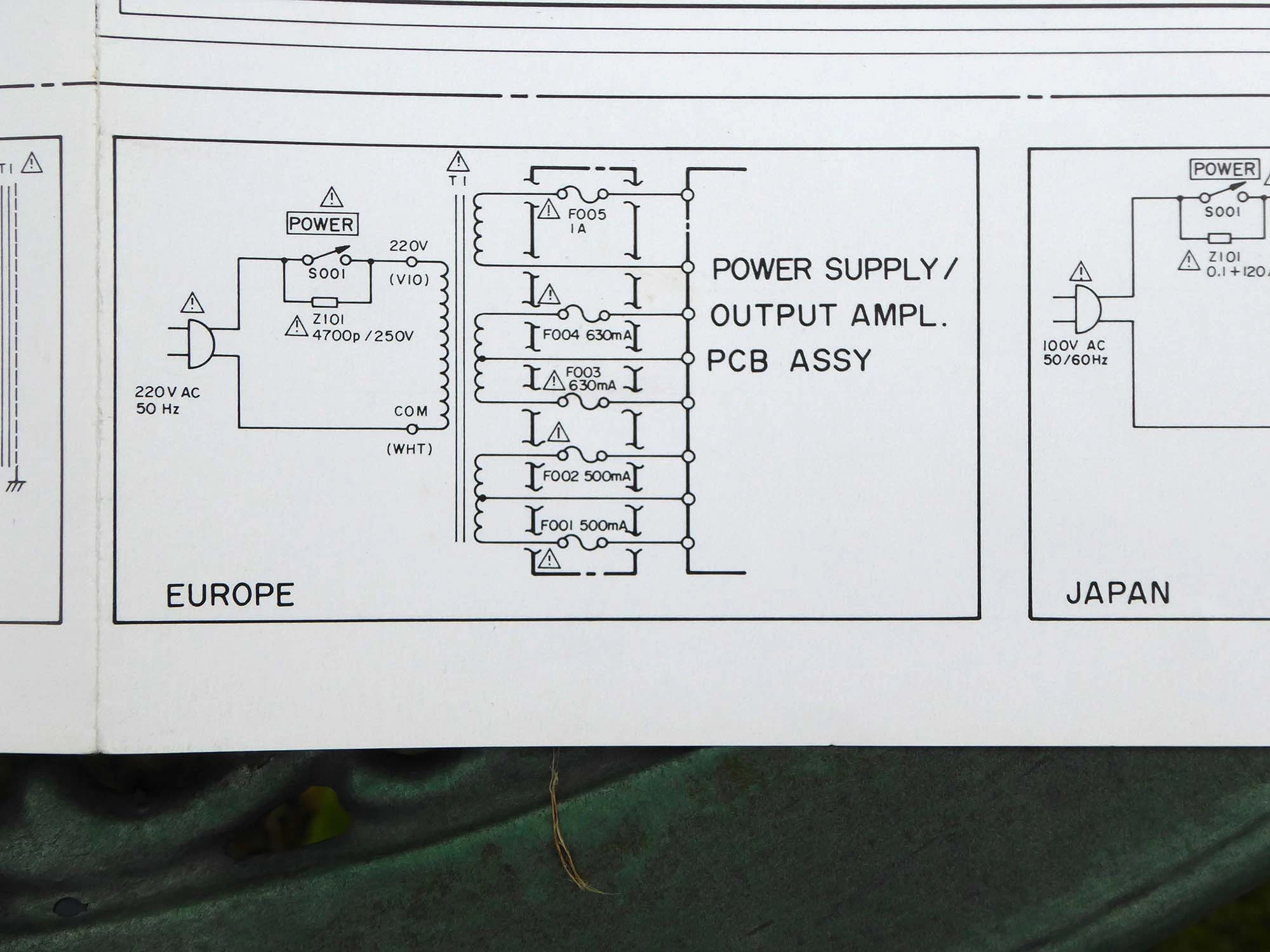

I can't remember how the fuses are labelled I'm afraid and I don't have my machine here at the moment to check. The panel is quite easy to see in my machine - they fuses all sit vertically. Maybe someone else with a 244 can take a look? Meanwhile, I have these sections of the schematic to hand which shows the fuses.
Thanks, that's almost perfect but I forgot to mention (and forgot to consider...) that my 244 is the Japan-Version (100V). Didn't think that there will be any big differences. Would it be possible to take another picture of the other side of the page?

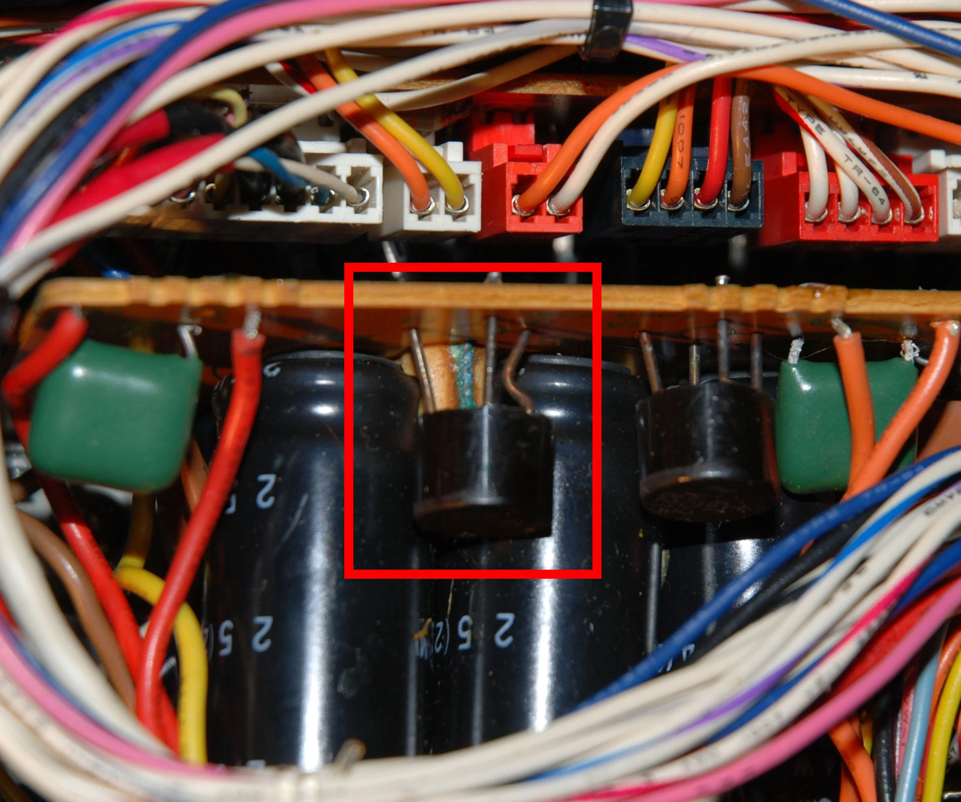

Alright, never mind. Meanwhile I found a rectifier (got the translation from the dictionairy, hope that's what they're called) that is somehow damaged. There is no signal going to the "lowest" wire in the picture which also doesn't look very healthy...DSC_0004_edit.webp

- The rectifier doesn't seem to be the problem. I cleaned the corrision and soldered it new. If it was dead there would be probably a lot more issues on my console.

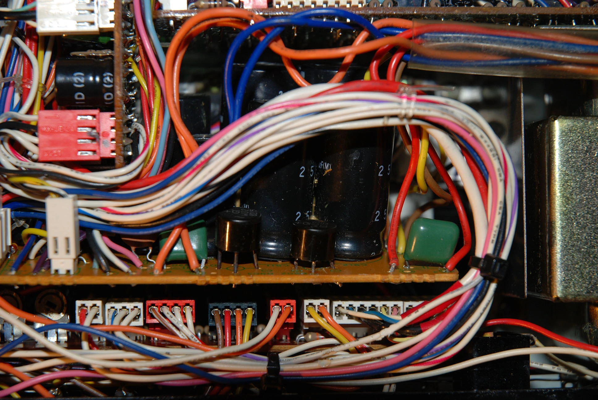

Here's what I'm looking at right now:
Trace the cables from the power transformer. According to the schematic, the fuses are the very next stop. Looks like it may be on a dedicated fuse board, judging from the enclosing box on Findlay's scan.
The cables from the transformers are connected directly to the power supply board. In the picture you see the red and orange ones coming straight from the transformer, next to the capacitors. I still haven't found a service manual which makes it kind of hard and I still don't know how big the differences between the different power supplies are. Mine is the Japan version with 100 V. Don't ask me why, bought it in Germany...

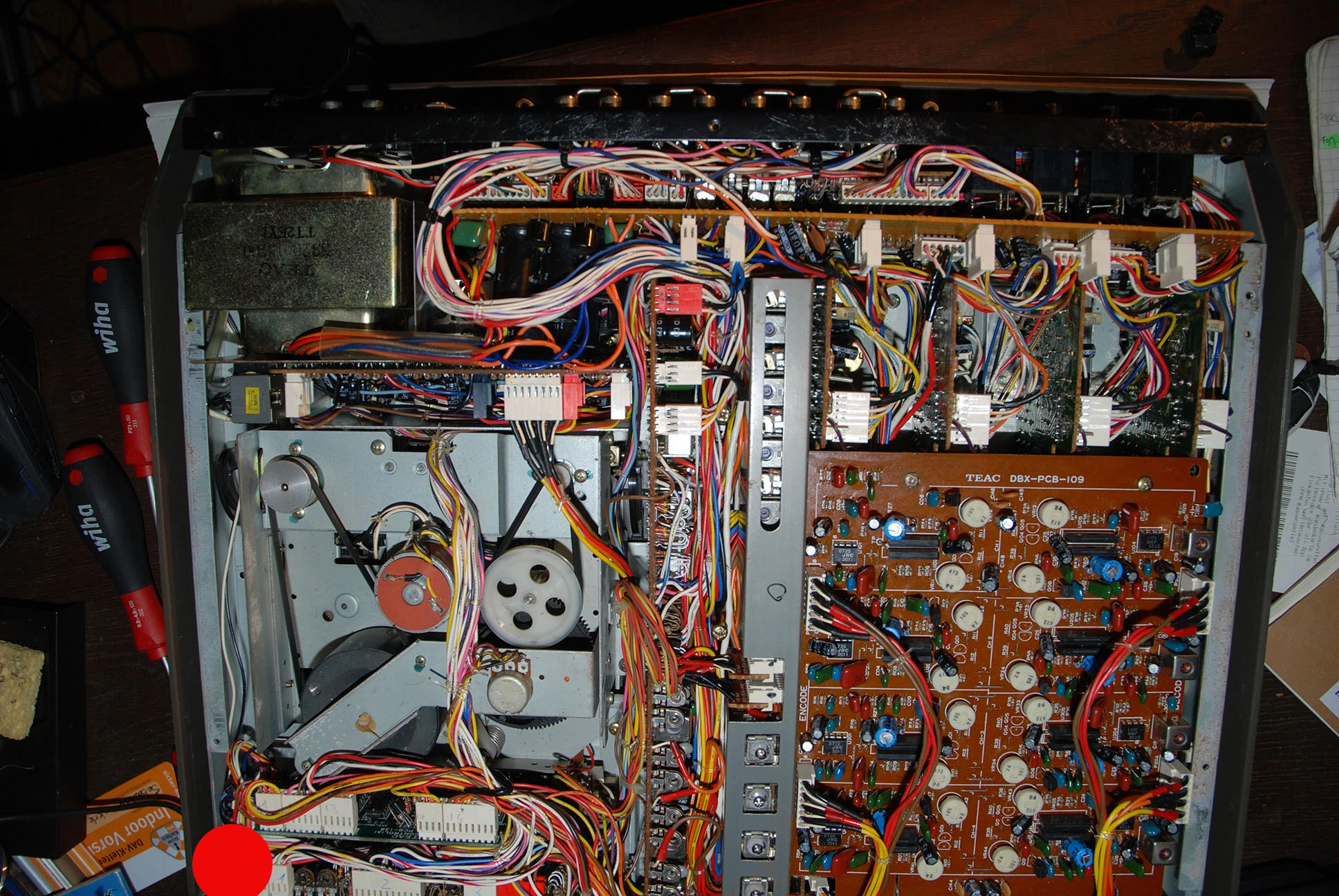

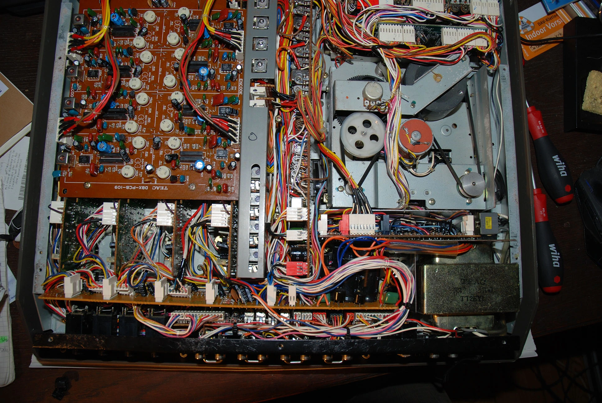

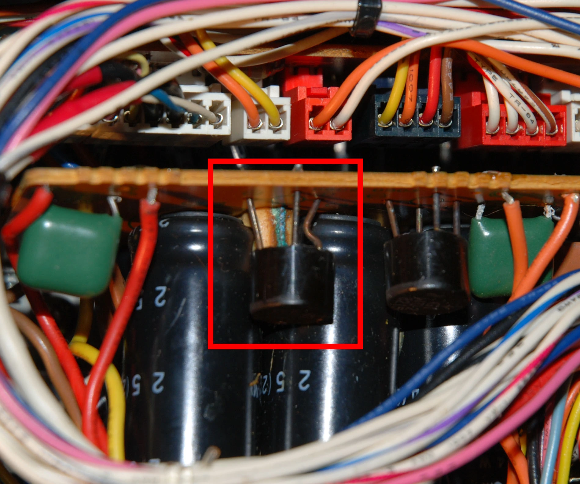

I've marked in red where I remember my fuses were - I may not be able to get to the machine for 2 weeks to check for sure - but this does seem to be a different design. I hope someone with the Japanese - or even USA version can help here. It would be strange if it didn't have them. Mine blow every few weeks now. I dread to think the damage that could be caused it they aren't there.DSC_0005a.webp
Yes, I might go on trying to find the service manual somewhere... Can't find anything at the spot you marked.
