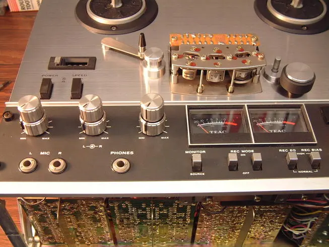

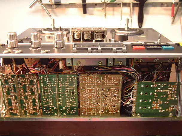

So when you try record it starts..hmm have you cleaned the (line/mic)rec-controls ?
You welcome, take off the 2 bottom feet and panel, that will make easier access for the three controls.
On the 5 record mode/eq/monitor source switches, spray from the top + below inside each switch and engage a couple of times afterwards.
Let the deck sit like that for about 30 minutes before powering up again.
Good luck :)
