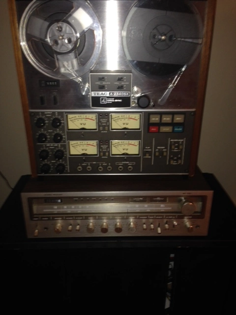

Embarrassing to ask this (I cant remember) A while back I acquired a Teac 2340sx a while back and the front has 2 - 1/4 inch headphone outs for "Front" and "Rear" what "splitter" or what do I need to use to hear this as a single jack? Like a regular Tascam Portastudo has. Maybe a 2 male end to 1 female end adaptor? If so, Have no clue where I'd get this. Thanks in advance!!

Use an external mixer, would be my best guess.
Any Y adaptor regime would run the risk of shorting out the headphone amps in the deck.

Ghost is right. Use an external mixer.
image1.webpI always thought this is one place on these decks that Teac droped the ball.
