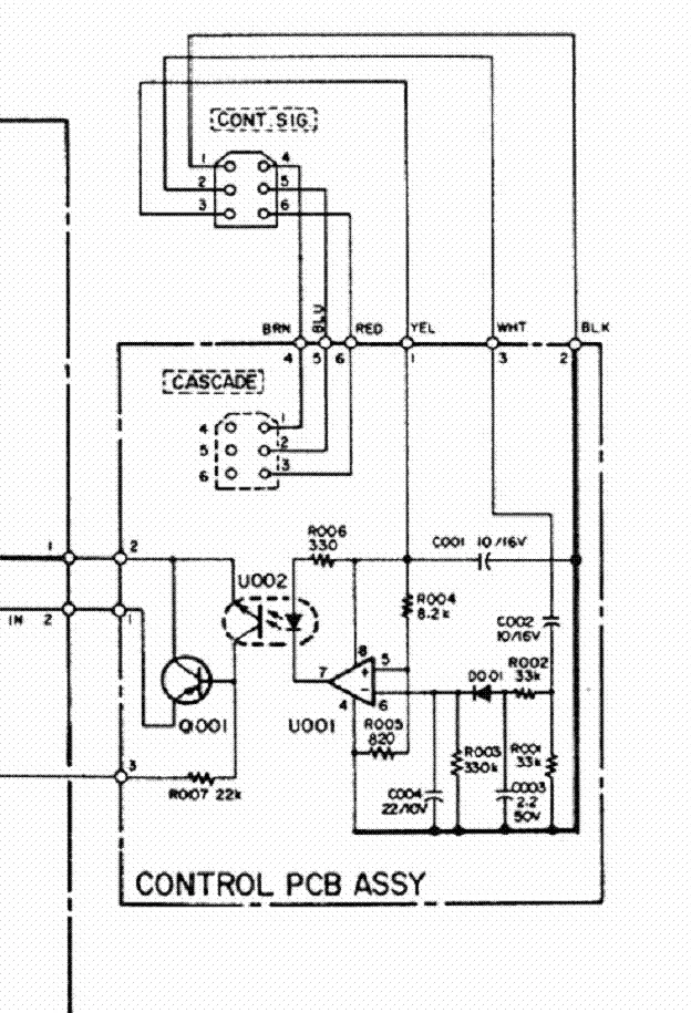

Tascam DX-4D Schematic
Hey RRuskin. Here's a copy of the Control Assembly section of the Tascam DX-4D. Is that Control Transistor you were mentioning in your previous reply in this schematic? :confused:
Thanks again for your help!
RevoStuder :D

I honestly can't tell you. I just know that they are in the cicuit somewhere. Try following the path from the control plug to the 1st transistor you hit. Then short out with a clip lead. If all the status lights come on for that channel - you've found it
