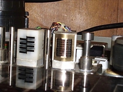

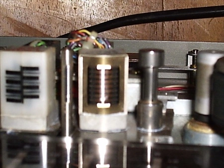

Here's the TSR8 heads, sorry about the quality! New capstan belt on it's way.
Thanks to all the guys on here!
Cheers!

pretty hard to tell from those pics. Erase heads "look" ok, can't really tell with the record/play head. The first pic, while blurry, appears to show the wear pattern on the play/rec head and if this is the case, it looks good, not too much wear and not too wide, but a clearer pic would be better. (I'm not saying the wear pattern is the bright line down the middle, that's the flash, the wear pattern appears to extend either side of the line and is lighter in color than the rest of the head)
