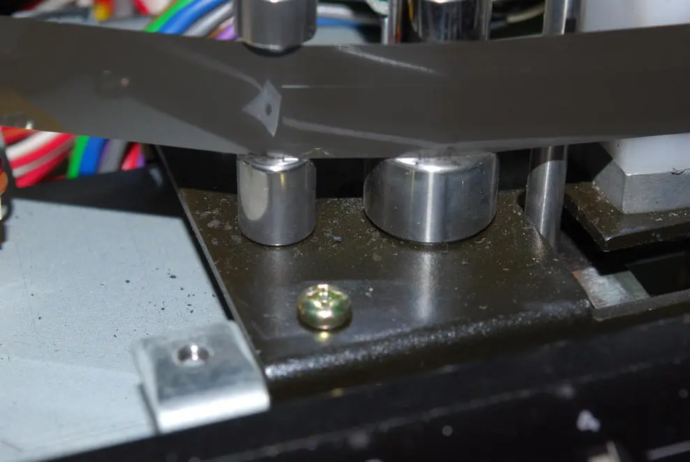

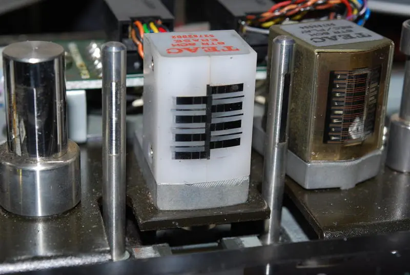

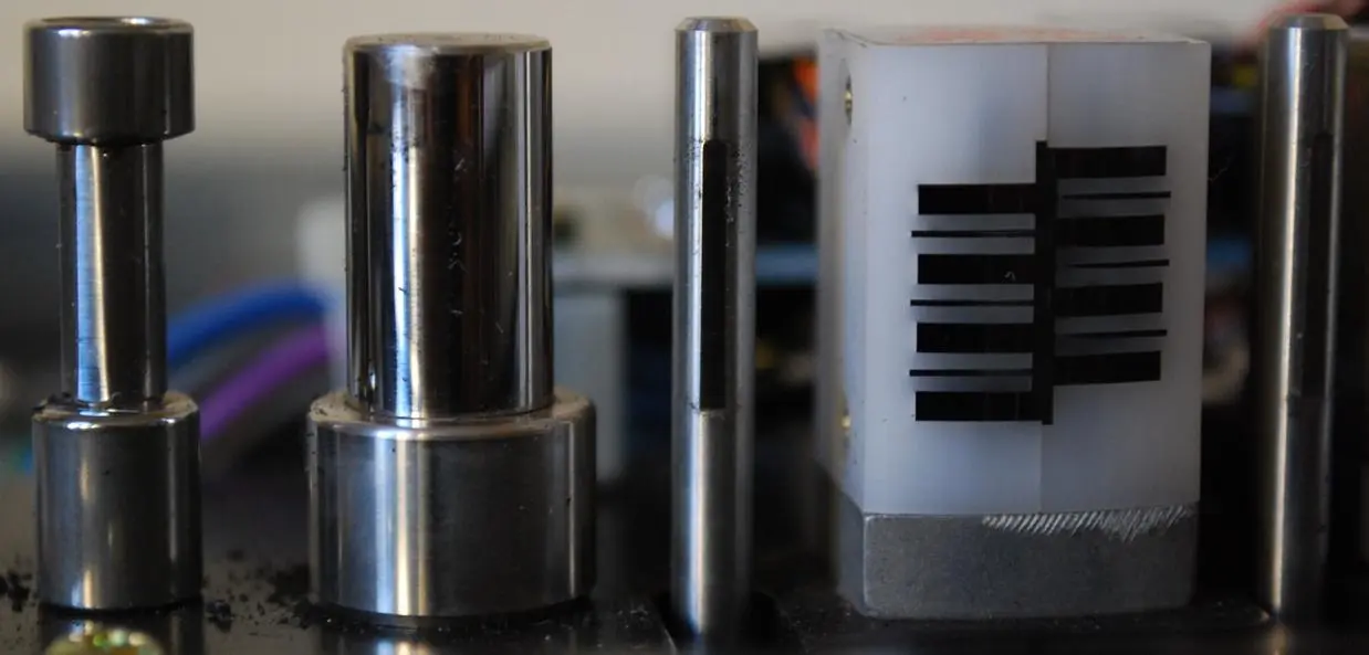

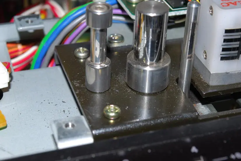

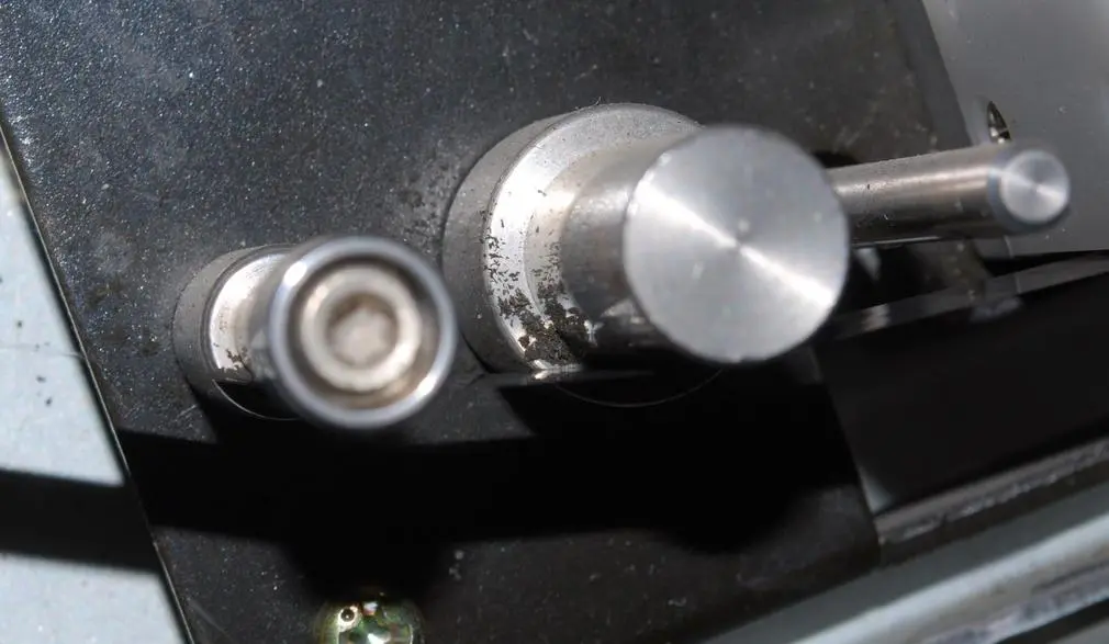

For second test I recorded 5 minutes of music to all the tracks. Recording worked but during the playback there was a considerable amount of "wow" in the tracks. Also there was a big pile of residue from the tape around the rollers and heads.
First I thought that there was some problems with the motors but after reading all the posts in this forum I came to realise the maybe this is a case of Sticky Shed Syndrome?
But the Pyral-tape is not been listed as a stickyshed-brand so could it be that the tape has a too tight contact with the rollers and it scratched the surface too much?
I took some pictures during the tests and i´ll add them later.
Thanks in advance for the help!
Please see the attached pictures

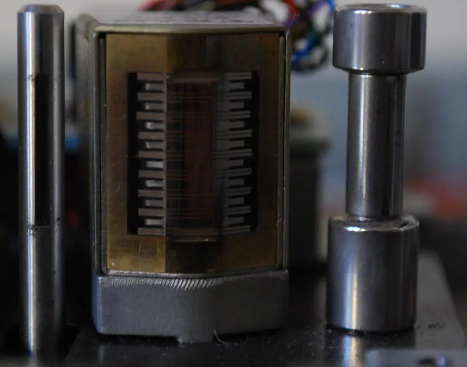

I'm very suspicious of that tape, personally. There seems to be an awful lot of dry shed, which makes me wonder about its integrity.
I'd try to get some SM911 tape and see if that works.
EDIT:
Is that stuff back-coated? It looks like it isn't. I have no idea what that would do.
Yes. I agree that the best next step is to get some new tape.
I wonder, though, does it make any difference in rewind if you manually lift up the left tension arm while in REW mode? If it does that could indicate a tension setting issue, BUT that can all be thrown off if the tape is bad so regardless I wouldn't run that tape on it anymore and get some new tape to try.
BTW, the heads look good. It looks like a fairly low-use machine.

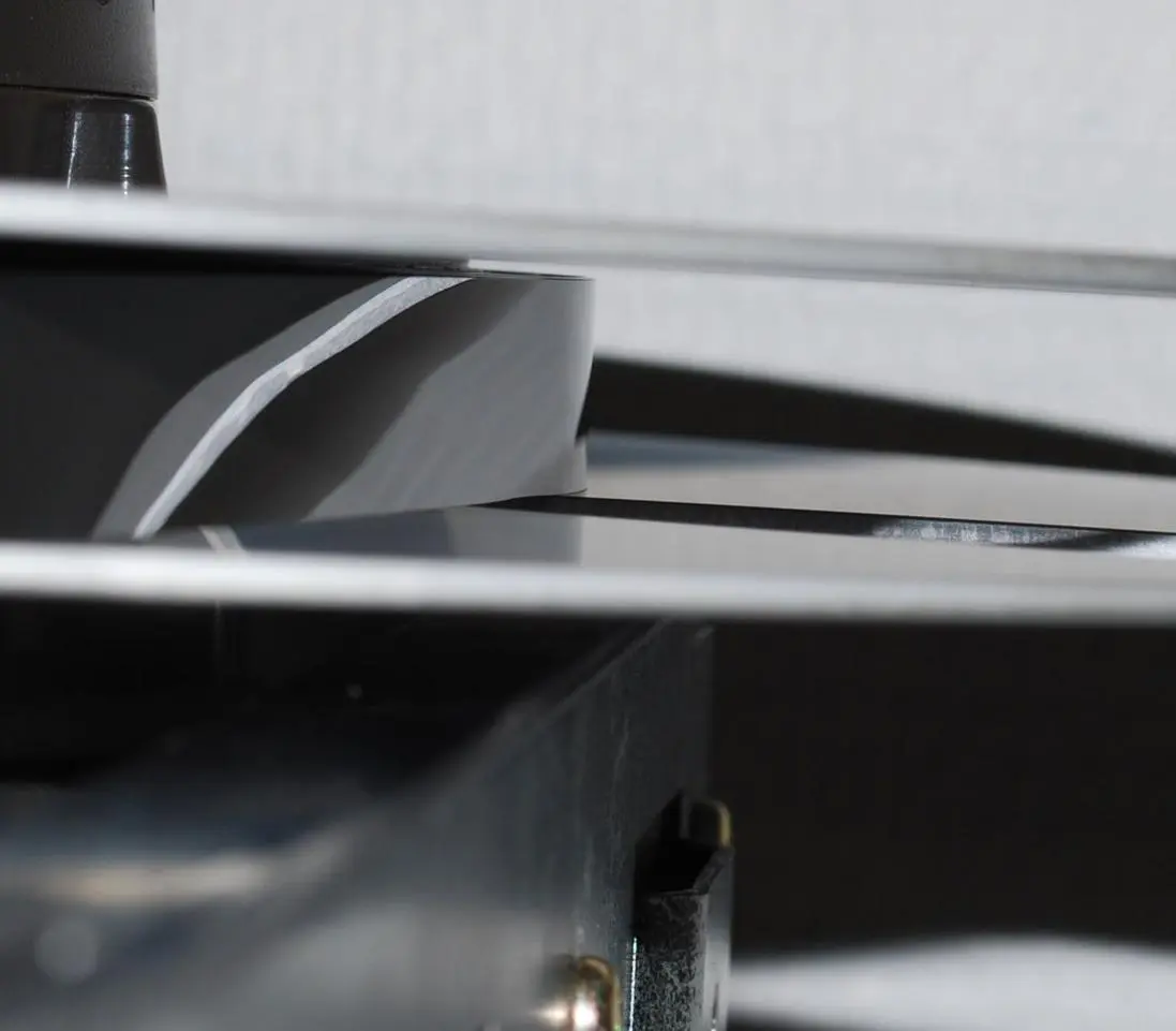

There was also problem with wobbling reel but I noticed that the takeup reel´s NAB adapter was broken and I have a new one ordered.
The tape didn´t align correctly but i´m not sure was it because the broken adapter or is the tape reel in a wrong height. I understood that there´s supposed to be 2 screws somewhere to adjust the height?
I´ll load a picture for you to see the tape alignment.
Yes. You have to get the upper front dress panel off and then (usually on the Tascam decks) there are two holes in the top rail (one over each reel hub) to access the two set screws that fix the hub to the motor shaft (either philips head or socket head). Then its just a matter of getting the tool through the access hole, loosening the first screw, rotating the table 90 degrees, loosening the second screw, adjust the height, tighten the screws and see how you did.
