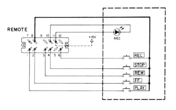

This question might be crazy, but would it be possible to use an RC-71 with my 58? Provided that there would be some way to look at the schematics and find some way to connect the pins on the RC-71 to the right holes in the 58.

It is possible, but you'll need to study the pinouts for the 58 in the manual for the remote connector, and somebody can probably offer some info on the RC-71/RC-90 functions. I'll check my 48-OB manual later to see if it has that info. You'll also need to get the ELCO connector to rewire the RC-71/RC-90 unit...I've purchased ELCO supplies from Redco Audio. You could also build your own remote.

Hey Kimo,
Don't know if this helps, but here is a pinout for the RC-71...I'm assuming it is probably the same for the RC-90.
I don't recall if you have the manual for your 58...I think you do, but let me know if you need the pinout for the REMOTE connector on the back of the 58.
Also, I have both the RC-51 and the RC-50, so let me know if you have any specific questions about those...I can research if it might help you.
Here is the RC-71 pinout:

Thanks a lot for the diagram. I do have the manual for my 58. I actually got it from the Reel Pro guys, with whom I had no problem. (not trying to stir up any drama related to that other thread, ha). Anyways I've decided to wait a little bit and see if a 50/51 pops up anywhere. We'll see how long my patience lasts though.
