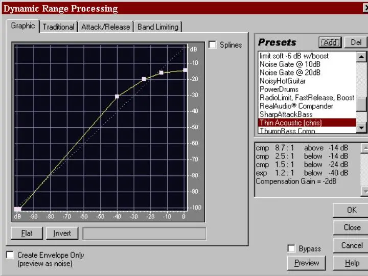

cmp 8.7 : 1 above -14 dB
cmp 2.5 : 1 below -14 dB
cmp 1.5 : 1 below -24 dB
exp 1.2 : 1 below -40 dB
Compensation Gain = -2dB
Immediate attack, maybe 15ms release.
I use this a ton when I'm recording this super "thin" guitar that I have (it's a thin body Takamine with a blanket inside to prevent feedback on stage). When you mic this guitar, it's similar to what you're playing.
Anyway, good luck...any questions about the above, just let me know.

So what you are saying is to throw 3 compressors and one expander on the guitar track? I should be able to do that in Cakewalk by just opening 4 sessions of the compressor/limiter/expander plug in shouldn’t I? Hehe…never thought about multiple compression on a single track.
Wait…how do you compress or expand below a given threshold? Now I’m confused. I’m not sure if I can do that with my Cakewalk compressor plug-in or not. :confused:

Think of the center line as infinity, and the db's get bigger up to 0db. When I say "below," I mean closer to the center line. I just cut and paste a preset I made, and that's the way that cooledit "thinks." If you're using Cakewalk, you have to do the expansion with a different plugin, but I *think* you can set up the compressor to do all 3 runs at the same time. If you can't, then the above is not really gonna' be helpful, because it won't work as well if you do it in stages. I mean, I'm sure it can be done in Cakewalk...I just don't know how...and I don't know how to do this with an actual analog compressor either. I'm posting a pic of the graphic so you can see that I'm doing is basically a modified version of the traditional "soft knee" compression.
Cooledit's compressor has taken me a couple of years to figure out, but now that (I think) I have, I love it b/c of the versatility. By the way, I certainly don't think I'm God's gift to compressor knowledge, I just remember that you've commented a couple of times that my acoustic sounds don't bug you, so I thought I'd pass this on. Hope it helps.

Oh, and if you CAN do this, and you listen to the acoustic track by itself, it'll sound like a huge pile of ass...LOL...but it works okay in the mix, I think.

Chris – Thanks for the explanation. I see how it all makes nice curve. Now it makes sense. I don’t know if I can accomplish that with the standard compressor plug ins I have in Cakewalk. I did download a demo plug in that was a dynamics processor the other day. I may have to see if that would do the trick I seem to remember you could set certain compression over certain ranges. Thanks for the help man. I appreciate it. :)
