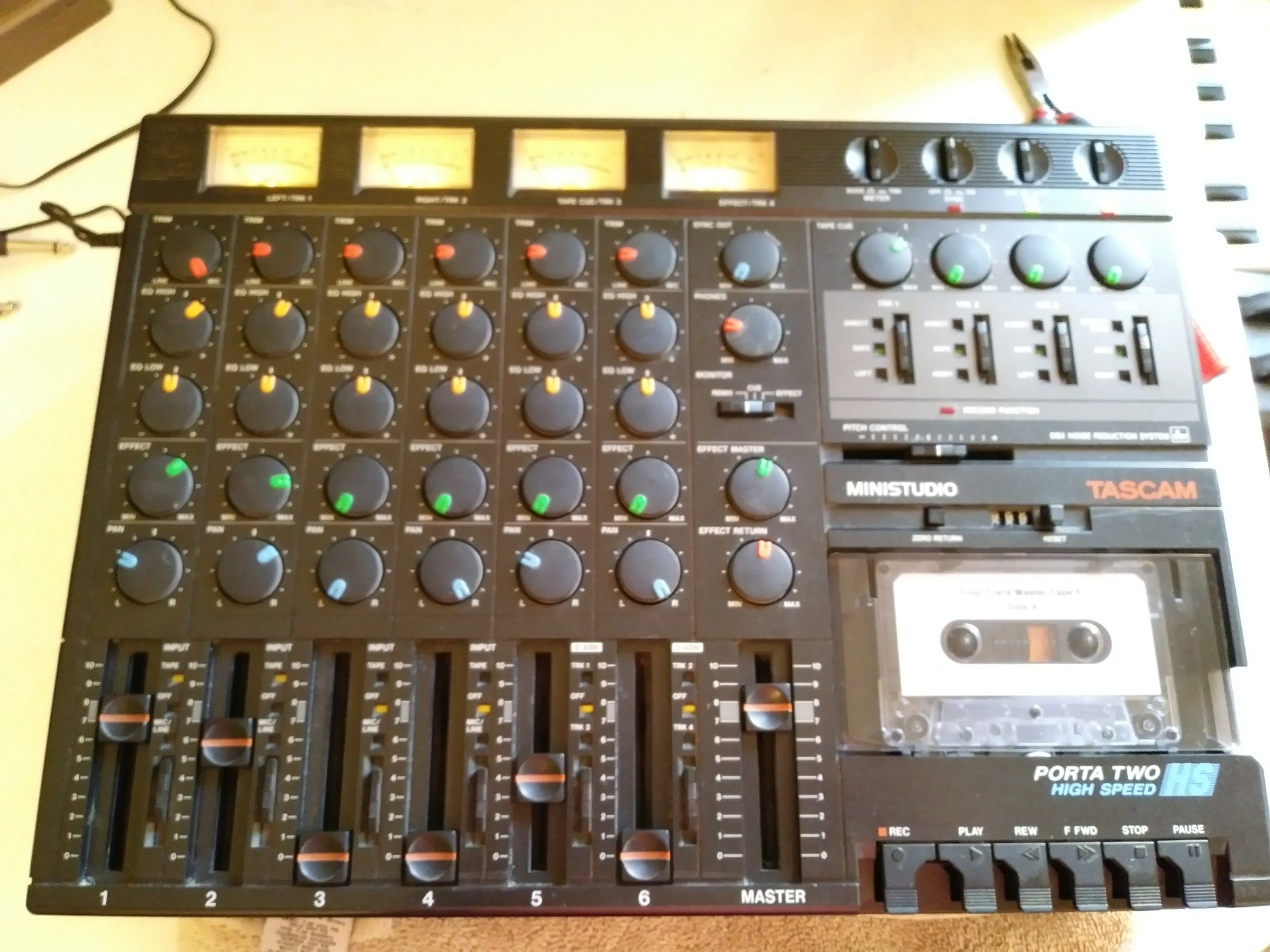

Well, it arrived (that was about 8 months ago I guess), and, despite the fact that the seller had assured me “It had been totally checked out by his guy,” it wasn’t functioning. I’m curious as to how the guy had “totally checked it out,” because when I got it, you couldn’t even stick a tape in the machine because the head stack was sticking out. I knew this was almost surely because the belt had been broken, and that would be a pretty simple fix, comparatively speaking, but since I wouldn’t be able to test out the rest of the functions before making this repair, I just told the dude it was broken and asked to send it back for a refund. Surprisingly, he refunded me my $150 and told me to just keep the machine. So that was pretty sweet.
I replaced the belt, and the transport was working great. After testing it, I found out that tracks 3 and 4 were recording very weak signals, though everything else seemed to work. So I put it aside for the moment.

So I picked that up when I was in Houston. After replacing the belt, which I expected it would need (and it did), I made a few test recordings and noticed that, again, it was recording weak signals on three of the tracks. This was basically the same issue my Porta Two was having. So, while I had it open, I decided to re-plug all the little connectors that I could get to. This was something that Sweetbeats had told me about when he helped fix my 388. So I did that, and sprayed some contact cleaner in the plugs while I was doing it. And holy smokes, that did it. All 8 tracks are recording and playing back beautifully now.
So … I then looked at my Porta Two and said, “Could it be that easy?” The short story is yes! I did the same thing, and now it’s working beautifully as well.

Last night, after fully testing the functionality of the newly repaired Porta Two, I made a quick test recording. I did part of Radiohead’s “You and Whose Army.” (I don’t know if you know that song, but it’s one of my favorites from Amnesiac.) I just plugged an SM57 straight into the 4-track (using an XLR adapter because it just has ¼” inputs) and used that for everything. Recorded my Epiphone jumbo acoustic on track 1 in one take. Then I recorded a vocal on track 2 in one take.
Then I added reverb by using a Behringer DR600 Digital Reverb guitar pedal in the FX loop. I used the plate reverb setting, and it sounds surprisingly good to me!
And I added some delay to the acoustic with my vintage (80s) Fostex digital delay rack unit. Even though the Porta Two only has one FX send, it also has a “Tape Cue out,” which sums the cue mix and sends it out, just like an FX send, basically. And, as the manual suggests, it can be used as a second FX send, which is really awesome. You can even return a stereo effect with this if you want by using the Channel 5 and 6 inputs. (The actual FX send has its own dedicated stereo return.) So I used that to add the delay.
