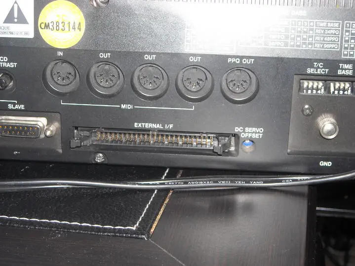

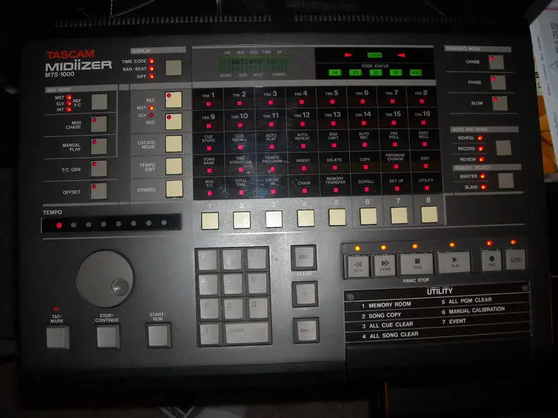

Okay, I'm a little late on this, and I didn't realize this topic got buried this far back so fast!
I promised some pictures, so here they are!:D

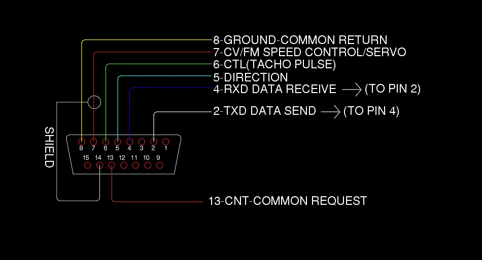

Hey do you still have the correct pin out for the ATS 500 synchronizer cable? It doesn’t seem to wanna load.

Someone has very cleverly broken all the links in the intervening 11 years. Fortunately, it turns out I did save a copy back in the day, though digging it up was painful and I was about to give up.
Here you go: I think I will also amend my copy of the manual to avoid losing this again.
