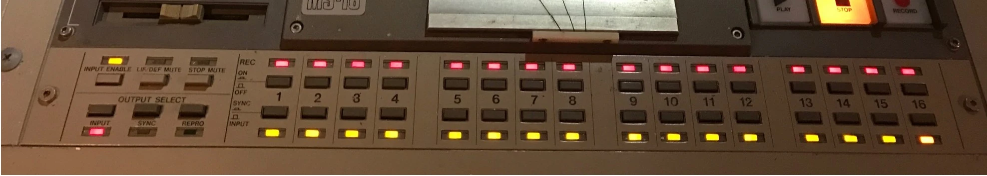

Is it actually missing the remote control unit or the actual arming panel? It will work fine without the remote. Everybody keeps saying it is missing the remote. That’s not a deal breaker. But if it’s missing the arming panel, THAT complicates things.
Unfortunately, it's the arming panel AND the remote:/
Bummer. Then it's a parts deck, or a heavy piece of furniture until/or if you can find the needed parts.
I myself would walk away.
