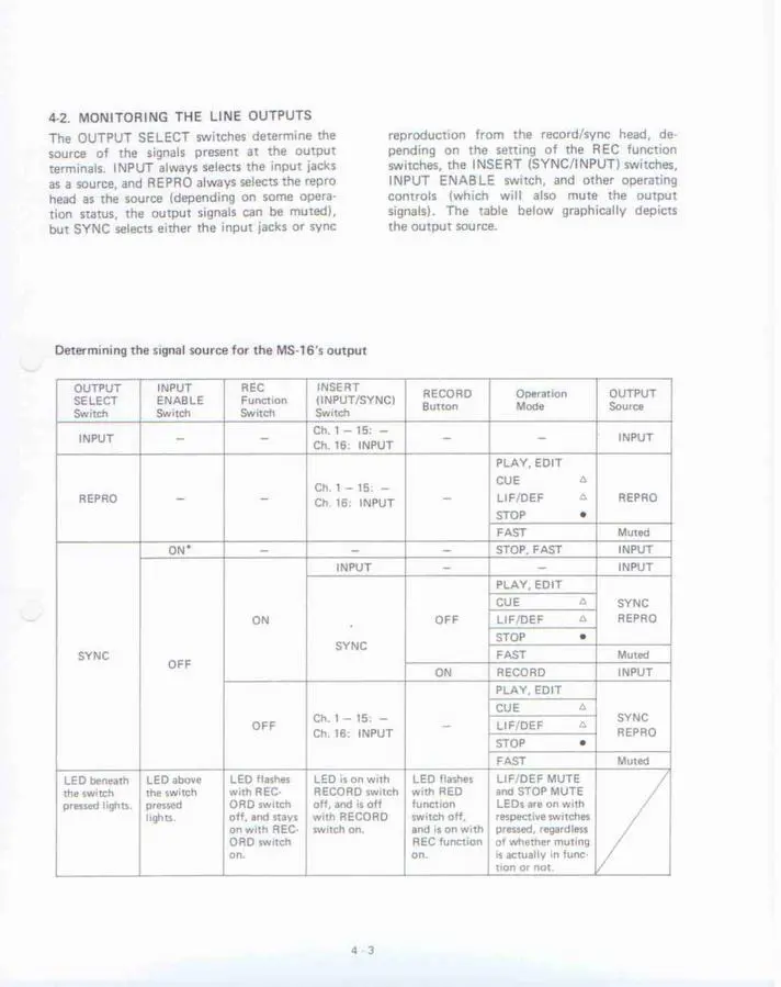

You should only need to select input to get the input signals to the meters (and also out the output jacks, look out for a feedback loop)
If when you select input as your source you get nothing (and there really is something there) then you have a problem with your deck.
You could check it channel by channel to verify if any fail or work.
Regards, Ethan

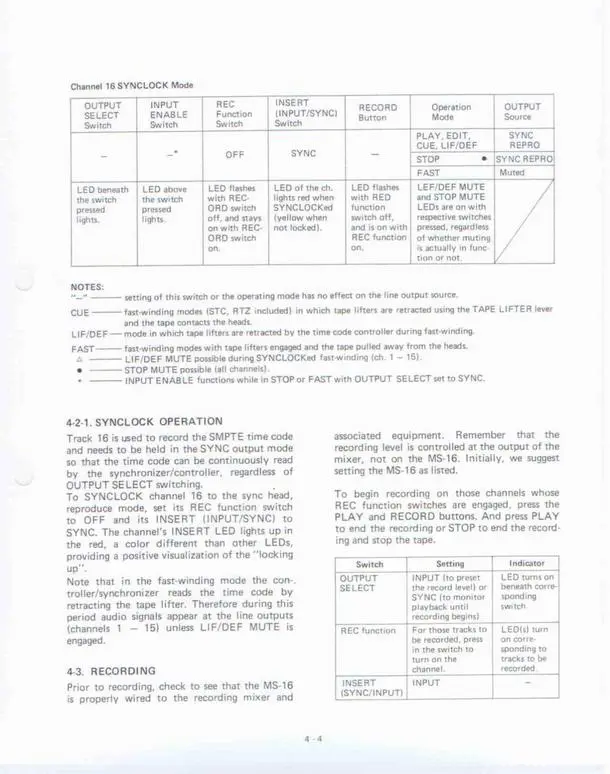

Some man pages for you
Thank you very much. I'll try again next time I'm at the studio. These scans should be a huge help.
Thanks a lot,
-MD
