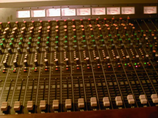

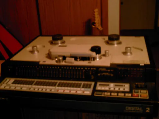

Heres some pics, sorry for the poor quality.

Unless the 3324 has the ability to switch to "-10" input/output sensitivity (which I highly doubt) you will need 48 channels worth of +4 to -10 bump boxes to go between it and your board. 24 to feed the machine/24 to feed the board from the machine.
I'm looking at the specs. it says
digital audio input x24...........specified input +4dbm.....gain adj. +10 to -6 db
max input +24dbm
impedance 10k ohms.......balanced
digital audio output x24..specified output..+4dbm(-2dbm).when load is 600 ohm
max. output....+24dbm(+18dbm).when switch is at unbalanced
impedance.....less than 100 ohms
not really shure what all that means. :confused:
Joe
Great mixer! I bought one just like it about 6 months ago. I totally re-capped mine and did some op-amp upgrades in the first 8 channels. I'd recommend the re-capping but the op-amp upgrade didn't make much of a difference. My board is very quiet and neutral sounding. Wish I could help you with a manual but I'm afraid you may have to buy one. You can probably find one on the internet someplace. The manual is very in-depth so I would get one if I were you.
I've searched high and low for a manual as a download...haven't seen one yet. I recommend you contact Tascam and get an authorized reprint from them. It will likely cost you little more than an unauthorized copy off of eBay or some such thing, and you won't risk getting an incomplete copy or a copy where the schematics can't be read. Get a used original or an authorized reprint. My 2p.
I think you'll be fine on the deck inputs, not sure about the outputs from the deck tho'. I think that -2dBu unbalanced level may be too hot for the tape returns on the 320. It may work with the line inputs though.
I used M308s for years. I still have my 2 that I bought new. Fine mixers. Very quiet and what you sound like is just what it records. Eq's ? Yeah they called it that and I'm sure they meant well, but oh well.
I don't recall the 320 having more than 4 busses or monitoring more than 8 tracks. The 320, 312 and 308 are all covered in the same manual and unfortunately mine are packed away in the original boxes with the mixers.
See the busses, buss assigns and monitor section in the picture? 4 buss assign buttons per channel. Even or odd which means greater than 4 track selection is done by ARMING tracks :ie Buss enable 1 down, channel panned odd gives output to bus 1 which means recording on tracks 1 or 5, buss enable 2 down, panned right gives buss 2 to recorder tracks 2 or 6, and so on. Or you could just use it balanced direct to 4 track and hit the buss 1 - 4 enable and pan straight down the middle. So you could use it either 4 track balanced or 8 track unbalanced.
Lift the line input button and stereo (channel) and monitor thru the monitor section when tracking. Effect (reverb) will be sent to the monitor section depending on channel effect send level. This will give you the 2 independent mixes you will need and still more are available from it via the auxes. The little mixer is much more complex than it ever appears and has routing capabilites that rivals mixers costing 10 times what it did. Btw, the M308 original (not B series ) cost $1300.00 in 1985 plus freight IF you really beat up on Washington Music. The 20, as I recall was $1800. I don't know if I got this all right and I'm sure I have all the quotes from the various stores around here somewhere.
You will also find the 1/4" line inputs, when they are used are insertion breaks which disable the mic inputs. Iirc, it just will not be suitable for more than 8 tracks. That's why most guys used either 2 M308's or 312's cascaded so that they could do 16 tracks or balanced 8. But maybe this weekend I can get to one of mine and get out a manual to make certain that what I have written is correct.

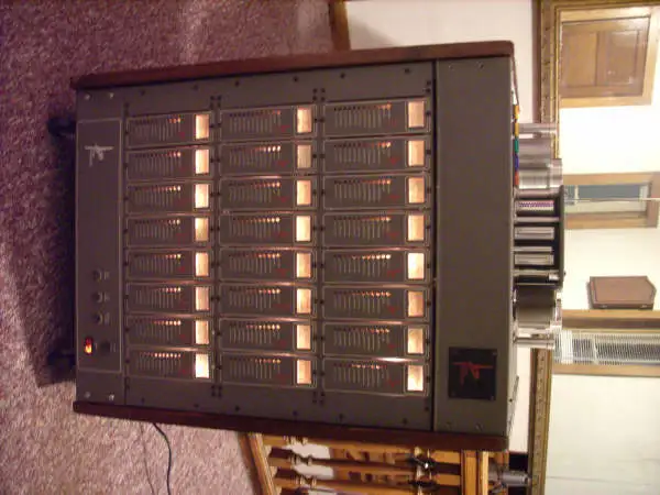

Ah i just bought this for $100.00 with the remote, picking it up sat.
What ARE you...some kinda deal magnet???
What is that thing anyway?
Impressive looking...
It's a aces/studiocraft 2 inch 24 track analog recorder. cant find a whole lot on it but Bob dylan had one in his home studio in the 80's. The Traveling Wilbury's recorded there first few songs on it. so if it was good for them. it suppose to have otari heads. and the remote is still wraped in shrink wrap! i cant wait to get it.:D:D:D ..............now, what else do i need:)
