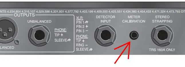

lo.fi... I've taken a snapshot from the 160A's manual. Here's what is says and take special note of the hi-lighted text. Looks like all you have to do is readjust for -10db operation.
