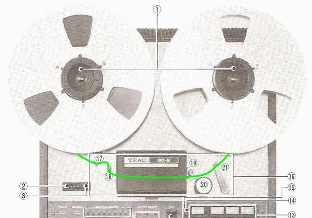

Hi!
Thanks for your quick replies. The tape I'm using is a used reel of Quantegy 456. I just got rid of pretty much all the rust on the capstan and I'm still experiencing the same issues. When I don't thread the tape through any of the heads (directly from one reel to the next) it runs pretty flawlessly, which makes me think the threading might be the problem.
Are there any pics available that show the proper way to thread the machine?
Threading diagram...
