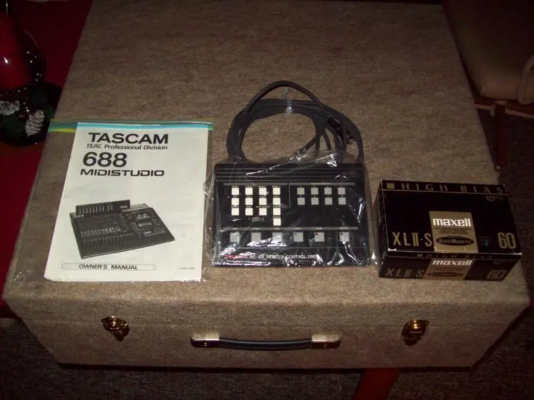

I've acquired the extra 688 from my girlfriend who bought it for me as a present.
I must say she came across a great score with this thing. It looks as if someone used it twice, and stored it away in a custom made case, along with a mint remote, & a box of Maxell XL II-S's since 1990.

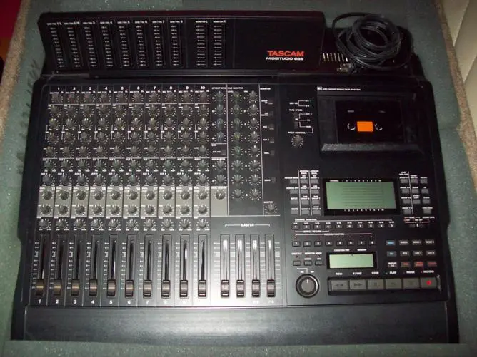

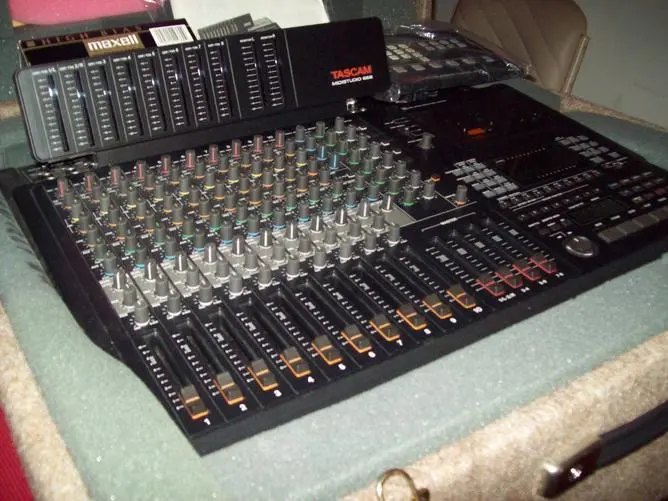

Beautiful unit! :D
Try mixing some 3-in-1 oil with Vaseline. Do not get it on the pinch roller.
Wow. That is sweeeet looking!
As the proud owner of a not-so-sweet-looking 688, it is really nice to see one so well kept.
