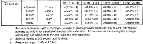

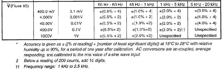

  6. And lastly is my Fluke 85 good enough for this?? My Fluke 85 is rated up to 20kHz but of course there are accuracy variances shown in a chart based on the band range...I don't quite know how to interpret those variances, and the bottom-line is that I'm trying to determine if my Fluke 85 is a reliable meter for accurately measuring levels at 20kHz. Can anybody help? Here is the accuracy chart:

I think that a Fluke 85 would cover your VTVM needs :cool:
Trust your Fluke (Luke use the Force)
Measuring a level of a 145 kHz tone wouuld be a problem for most meters....
-Ethan
PS no need to buy a scope. a software scope shold be fine for azimuth and the few times you need a real scope you could borrow one.

  6. Partially answered...So for my Fluke 85, I can assume that if I am reading a 0.615VAC signal at 20kHz, that the actual voltage may be 0.590 ~ 0.640VAC (0.615 +/-4%) right? That's about a 0.7dB swing...I can swallow that, though 20kHz is at the edge of the rated accuracy specifications...But what is that +4 next to the 4.0% on the spec page (i.e. on the 4.000V range from 5 ~ 20kHz it says there is an accuracy of + or - "4.0% + 4"? :confused:
