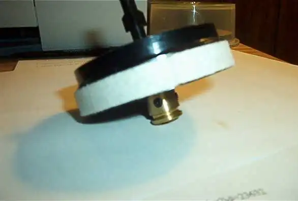

Here is the part you need to replace . It has two set screws on the brass shaft on the bottom for adjustment or replacement.

Ok, so I will need to get up under the surface where the reels go in order to remove and replace it, and I'll have to replace the disc part and everything(I guess it's all one unit). What is that unit(the one in the picture) called so I can ask around and search for a replacement?
It is called a reel table. And if you decide you want one this one is for sale.
You can send me a pm here if you want to know specifics.
To change these you have to go through the top of the machine to do it.

Alright, I have the reel table to replace the broken reel table on my Tascam 388. The only problem is I'm having a hard time figuring out how to get in there to replace it and I can't find anywhere online that tells how. I tried going in from the bottom but that didn't seem to work, and I tried to take off the top panel and the transport panel but I had no luck getting those off. This is frustrating and I don't want to take it and have some random person get in there and charge me an arm and a leg. So does anyone know how to replace this reel table????
You have to remove the cover plate that covers the deck of the transport.
The head cover as well as the tension rollers have to be removed, IIRC. :eek: ;)
Yeah it looks like a couple of the parts will have to be removed, but I don't even know how to remove those.
The head cover comes off with two screws, one on either side.
The tension rollers come off by unscrewing their caps. Pay close attention to two very small washers, one on either side of the roller.
I can't remember if the pinch roller has to come off too, but it would come of in a similar fashion, by unscrewing it's cap.
The reel table set screws are on the bottom side of the reel table.;)
