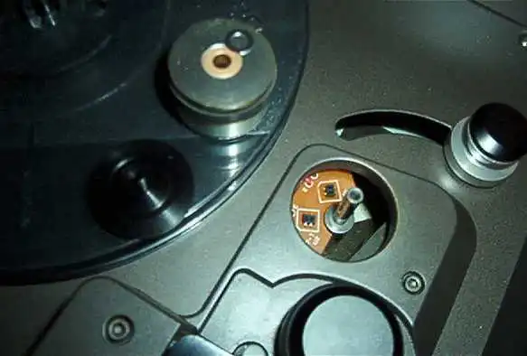

The roller immediatly to the right of the pinchwheel is the tach roller. The tach roller is the source of counting/position sensing on the 388. I haven't looked directly (although I looked in the manual), and I'd believe it to be an led photosensor and a tach wheel. Either there's some looseness in the tach roller/tach wheel assembly itself, or maybe the tach sensors need cleaning.
If it won't count accurately, look at the tach roller and sensor.
If the counter display goes on & off intermittently, look for a bad connection. Maybe reseat the connectors.
First thing I would do is unscrew the black cap on the tach roller that reel mentioned and take if off of the machine. Be careful there is a little back washer on top of the roller under the cap.
Maybe use just a q tip to wipe the two little sensors off that you will find under the wheel off. There could be some dust or funk on those that would keep them from working correctly. Also could be the rubber on that wheel has got hard and needs some rubber conditioner used on it to soften it up some. Could be hard and letting the tape slip. Also could be the shaft needs some lube (light oil) on it.

So, looking directly at the sensor, do you think it's optical or maybe a Hall-Effect sensor? I think maybe a hall effect sensor,... that detects the movement of a little metal tab underneath the tach roller.
Herm's also right on with the note that if the rubber on the tach roller is hard, it will not grip the tape as it passes, and therefore would throw the counting off.
Boy I dont know Dave Im not that familiar with those at all.

You're responses have also brought some new questions for me: First, can someone recommend a rubber conditioner? Second, when I clean the sensors with a cotton swab, should I use an alcohol-based cleaner or head cleaner on it, or just use the swab dry?
Thanks in advance for the help! If it is a hall-effect sensor, it seems more likely that the problem would be linked to the roller rather than the sensor. Just a thought there.
-Eric
Unarmedman,
Recently I had the exact same problem with my TSR-8, and this is what I did to solve it. I used a dry q tip, and very lightly swept across the two sensors, and then I cleaned them again with a puff of compressed air making sure not to shake the can and to hold it upright like the directions say. You may also need to clean off the backside of the counter roller as mine was all greasy and full of little dust hairs which probably kept the sensor from reading its black/silver pattern properly. Another thing I did was lightly oil all of the roller shafts with 3-in-1 being careful not to drip on anything that didn't require oil. Finally, I conditioned the counter roller and pinch roller with Caig Laboratories' "CaiKleen RBR" Rubber cleaner/conditioner which can be bought from their website at: www.caig.com. After I did everything I carefully put everything back where it belonged, making sure not to lose any of the little washers used on the rollers, and my problem was solved! The majority of this information was given to me by Beck and Ghost so thank them if it works and good luck!

Cleaned the tape path, used fantastic on the pinch roller & tach roller, took off the tach roller and wiped the sensors with a cotton swab, cleaned the bottom of the tach wheel, and reattached everything.
So far, RTZ seems to finally be working! I only tested it twice, the first time 3:40 into the tape, the second time 24:00 in. Both times it went back to the exact same spot. Finally!
Now, one time when I pressed play (before I had reset zero) the tach roller didn't spin, and I noticed the counter wasn't moving. So that problem isn't eliminated yet, but I do know now that it is because the tach roller isn't catching the tape. So, I'll be ordering some of that Caikleen RBR, and will try that out!
