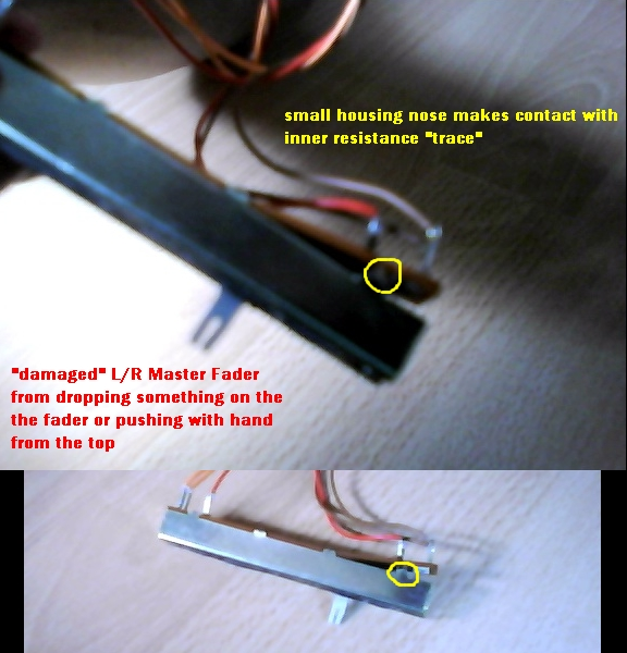

Opened the fatty up and as i thought something got dropped on the STEREO L/R Master Fader. (CH3 FDR too)
The "conductor" plate was popped out of the metal casing on some places, thats why this Fader (and
Channel Fader number 3) is so "bumpy" like a bumpy road.
All other Faders look fine and as i said earlier, all Faders were working good so there is no real
damage i just have to reassemble them properly again after little cleaning.
I can't see anything suspicious elsewhere.
Here is my question for you guys: Could my not working TRK8 problem stem from the messed up
Stereo L/R Master Fader?
Edit : I'm looking at the L/R Fader right now and i think what happened there is a "short".
I explain. The plastic board which holds "Conductortraces" and cables got popped
out because of pressure from the top towards bottom somewhere back in time.
now there are little "noses" on the metalchassis which hold this plastic board in place
after assembly. These noses have not been bend while pressure was applied from the
top, they are still in "closed" position. one of these noses makes contact now with
one of the "Conductortraces". To me this says not much because i have no clue about
electrical stuff, but it looks like a electrik "shortage" to me because the housing
of the fader makes now contact with one of the "Conductortraces".
Can someone verify this?
edit : my father told me these are "resistor" traces, pardon
The STEREO fader would not effect one track/buss.
Pictures would help.

i know this LR Fader cant directly be the cause, but like i said there is maybe a electrical shortage
between the housing of the fader and the inner traces, some little FDR housing-clamp-noses touch the "resistancetrace"
inside, maybe weird things start happen because of this...the pgm master buss faders are ok.
but i will open all faders to rule this out...pictures idk..its a mint 388 inside and outside,nothing to see.
first i rule out the faders...if necessary i swap the cards after try out and then i report back. thank you.
Mint? I thought you said there were some problems with the STEREO master fader?
I asked about pictures because your written description isn't completely making sense to me as far as the problems with the STEREO master fader.
But the bottom line is that if ANYTHING is working on the left and right main busses, then there is nothing wrong with the STEREO master fader, and the advice you are getting is to swap the cards. That is the first thing I would do. So do whatever you like, but I'm waiting for the results of that test.
webcamphoto of the "pushed open" L/R fader attached.
nothing broken.
pardon me I ment the overall cosmetic condition of the 388 is good,
thats why i said "nothing to see there"
i report back as i progress.
