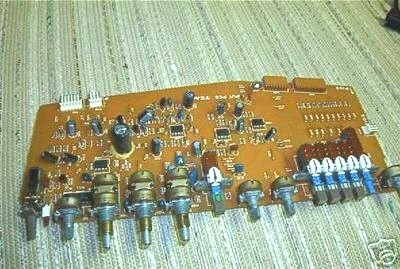

Also, here's a pic of the channel card (complements of Herm sometime back... if I remember right). As you can see, repopulating the entire board with new op-amps, caps and resistors is not all that difficult... there just isn't much to it (if you've done this sort of thing). It's the shotgun method, but sometimes it's the cheapest, easiest, and fastest option in the long run. Any way you slice it it’s going to take some time and/or money to remedy your situation.

oh god! i just now caught this. i finally got a chance to crack the 388 open and sure enough its the card that's bad. i hope i can find a replacement. if not where should i get parts to repopulate the board?
