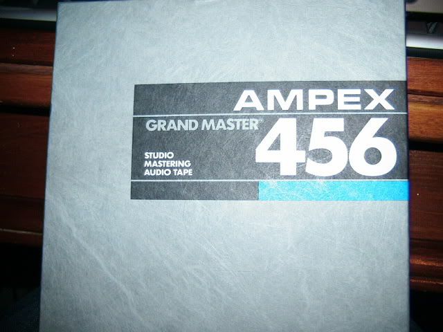

I took a picture of the Ampex cover. I guess you can tell the era by the design?
Yep, that's one of the old sticky era boxes… early 1994 back to 1987 (maybe 86). The newer boxes have the Ampex logo along the bottom instead of the middle… very easy to think they look the same if you aren’t looking at the two different styles side-by-side.
By the look of the other tapes in the picture my guess is those Ampex tapes are probably from the late 80’s. The date code on the old Ampex 7” stuff is sometimes on the hold-down tape on the reel. You have to open it to see exactly when it was made. It will be something like 89215, with the first two digits being the year, as in 1989.
None of the other tapes I listed have sticky shed, except of course Ampex 407/457 made before late 1994 (1995 to be safe).

Well, it says 4,5,6, on the tape on the reel. On the inside of the box is 000012XX15. Too bad it can't even be sold or anything.

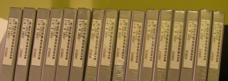

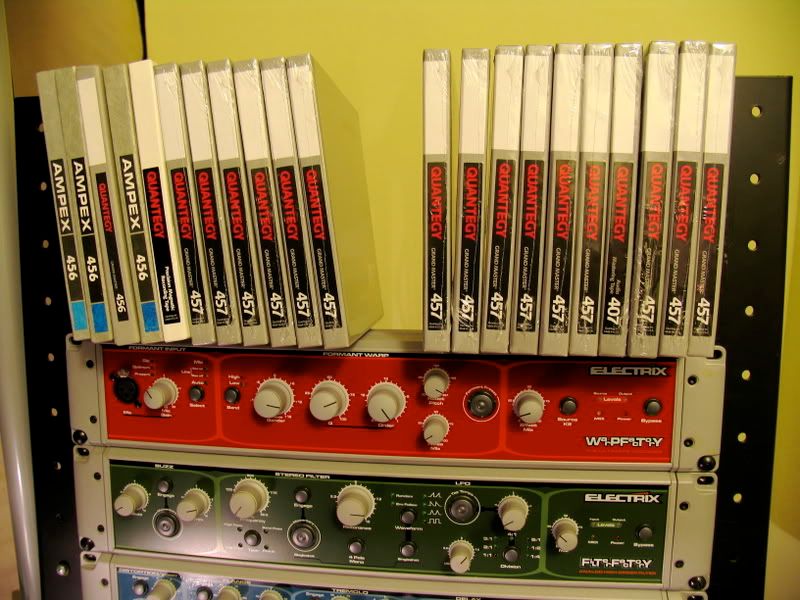

Say, what's your take on the quantegy stuff offered in their final days? When it got down to $8.25 a reel for 457, i went a little nuts and grabbed 16 reels!!
Hoping that wasn't a mistake. I've read about their final 1/2" reels having trouble with slitting and such. The first two reels have been fine. The second pic shows the manufacture dates.
(click)
Erockrazor: Ask shedshrine (nicely), for a 457 reel. He seems to have plenty! Pretty please...:o:o:D:D

Shedshrine is probably slapping himself for showcasing his collection of 457.:eek:
Yeah, man! You bet, but please don't ask about my 7" reel empire,...
of well over 100 reels of new tape, or maybe 2, but I haven't counted!:eek:;)
