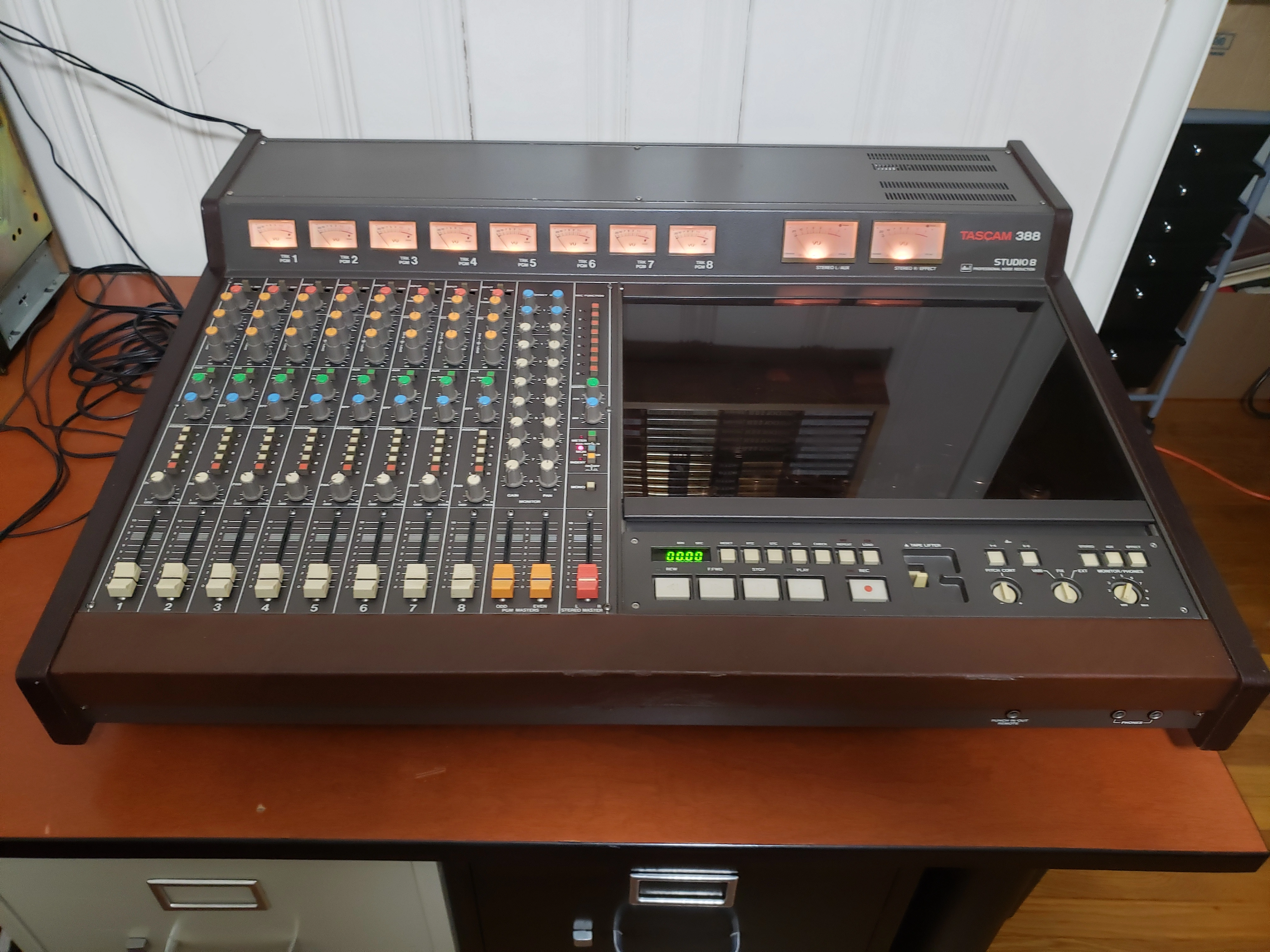

I inherited a Tascam 388 and it has a problem on Channel 3.
I am able to record to all eight channels and I can get output from the tape out on channel 3 but there is no activity on the meter and no output from the main bus. There is also no activity from the VU Meter for channel 3.
I have tried swapping the audio cards with another card in the same unit and the same problem exists. Could it still be a dirty connection? What else might be the problem?

Hi sweetbeats, yes that is correct. I did not however test with a mic, just the line in. I tested all 8 channel line ins in fact. I am able to route any line in to any track. It records the input to channel 3 and I can hear it from channel 3 tape out, just not from the main outputs.
And the meter issue…so do I understand correctly at no point under any conditions can you get any activity on meter #3?
No sorry. I do get activity on the meter #3 when recording or monitoring the input.
Are you able to hear track 3 reproduce through the monitor mixer?
I am able to hear an output from channel 3 on the PGM out. I still have no activity on The vu meter during playback though, only during recording and monitoring of the inputs. I also just discovered that I cannot pan left on channel 2.
Another interesting piece of information. When I press the monitor button in or out I get a loud pop from the speaker and the Vu meter on track 3 pins momentarily.
Also, when I first turn on the unit the meter for channel 3 moves, but it is the only meter that does move.

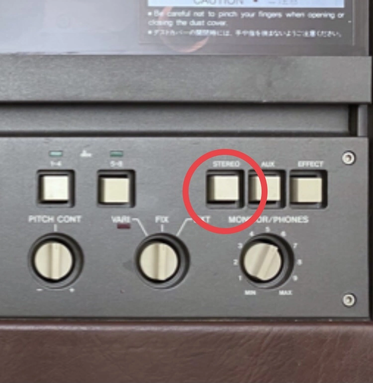

No they are not. Turn up the level of channel 3 of the monitor mixer, and then over to the right of transport controls is the monitor source select switch. Set it to MON, turn up the headphones level and see if you can hear track 3.
Thanks for your patience with me. I need to make sure I have a clear understanding. while playing back a tape, I turned up channel 3 of the monitor mix, and set the monitor source switch to the down position (Red LED On) and I get no output to the phones on any channel, including channel 3. If however I set the monitor switch to the up position (LED not lit) then I get output to the phones on all channels EXCEPT 3.
I think what you are calling the monitor source switch is the track arming switch. I don’t know. The monitor source switches I directed you to over to the right of the transport controls do not have LEDs. Are you talking about the row of switches to the right of the monitor mixer?
I’m talking about pressing the switch down that is circled in red:
So push that switch down and do the following:
1. Ensure all 8 L-R assign switches on the input channel strips are in the up position
2. Ensure the CUE/PGM switch is in the CUE or up position
3. Ensure all the track arming switches are in the off or up position
4. Turn up the level knob of monitor mixer channel 3. Turn the 7 other level knobs fully counter clockwise.
The machine is now setup to monitor tape track 3 in the headphones when you press PLAY. so adjust your headphone level, and press PLAY. Can you hear tape track 3?
