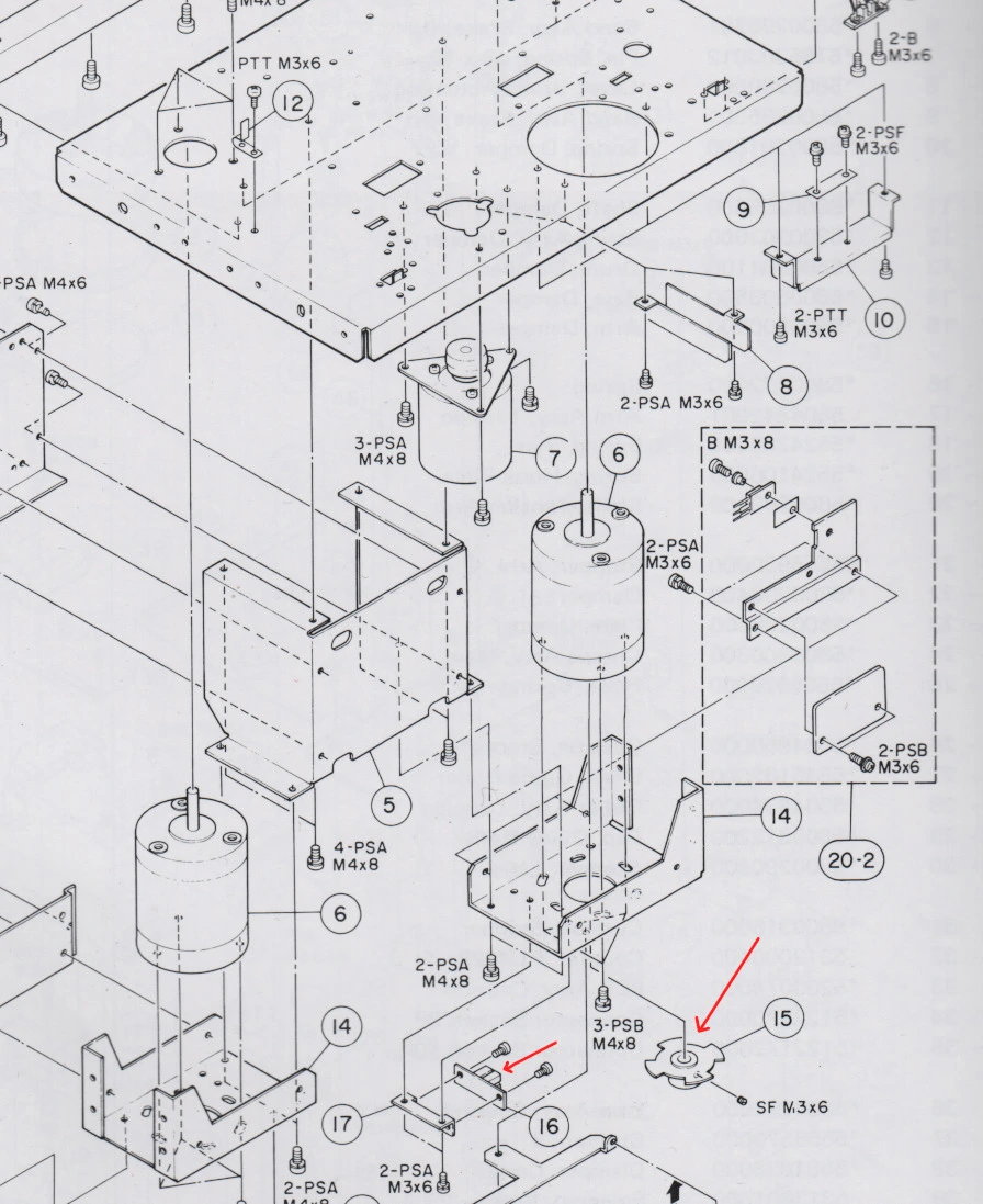

That third input comes from a set of yet more logic gates fed from the motion sensor circuit, which is driven by a rotary encoder which is attached to one of the motors.
If that's the motor you removed, you need to check that the encoder is still in place, that it's still rotating when the motor turns, and that the vanes are still interrupting the photosensors. If it's not doing all of those things, you're going to get some very, very strange results from the reel motor control logic.
Here is the encoder:
