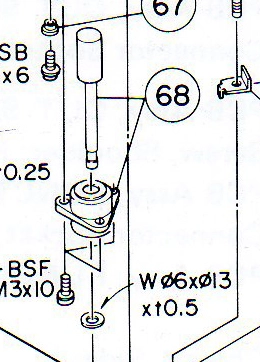

Inside the flywheel, there is a metal washer with rubber bonded to it. The rubber will have turned to goo. On my 34 I added an M6 x 5mm or 6mm Teflon spacer to the flywheel shaft.
I don't know if you will need the same size spacer as I don't have a diagram of the 38 assembly, the attachment is of the 34 capstan/flywheel shaft
  • From the front, go through the same procedure as replacing the belt.
  • Lift up the complete assembly with the flywheel.
  • Undo the two screws that secure the flywheel to the shaft, (take note of how much of the capstan protrudes below the flywheel
  • Remove the washer from inside the flywheel and clean away all the goo
  • Fit the nylon or Teflon spacer to the shaft, then put the cleaned washer back
  • Reassemble the flywheel onto the shaft
  • You can now put everything else back together

Wow! Thanks you so much for the in depth reply. Yes, a space would seem to be the best option. I was hesitant when I had the assembly apart yesterday since I wasn't sure how it would impact the rotation, but I can't see any other way to go. Off to the hardware store...
Thank you again for the input.
Yep, 2 20 cent plastic washers and I'm off the races! Seemed like cheating I guess yesterday, but you can't argue with a simple solution. Thanks again.
