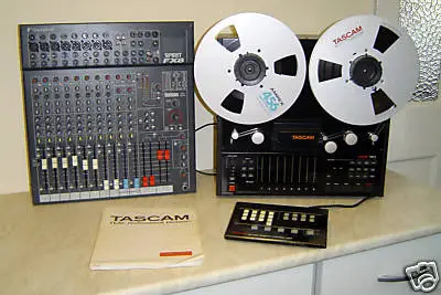

I found the setup of the picture: a Tsr-8 with remote controller + a Soundcraft FX8+manual and leads and this is the one that I finally purchased.
As I'm planning to record live and to edit/mix at home, the deck+small mixer setup is going to be more convenient than the big but mighty cool 388 (next time).
Now I got two mixers a M-208 and this one. I suppose I should try them and keep the one with better pres, etc.
Thanks again for helping me.
