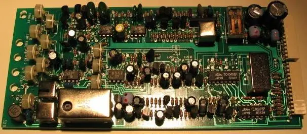

Picture of a 48 amp card...
A smallish picture is below, but a native file of the picture can be downloaded from here.
As already acknowledged, the 48 cards are completely different. A significant point to note also is that all of the bias level amps reside on two separate cards.

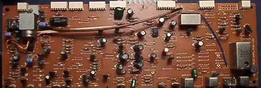

Well I was going to post a 38 card but my batts died. The pic will be here as soon as my batteries get charged up.
That'd be great. Thanks Gary!:)

I was just noting it because it was interesting to me when I opened up the 48. The 58, and I'm assuming the MS-16, have 1 separate card that houses the master bias oscillator, and then each channel amp card has its own bias level amp and traps. The 48 cards have (what I believe to be...haven't looked at the PCB parts list yet or studied the service manual) just the bias traps (as far as bias adjustments) on the amp cards, but the 8 bias level amps are on two adjacent cards, 4 each. Don't know why. Might have just been the physical engineering of the deck...a solution to be able to access all the trimmers on one plane and not waste space...that is one plus for the 48 and a minus for the 58: while I like the trimmer access being right on the front of the 58, a number of trimmers are placed behind the front row. The front edges of the cards are not big enough to have all trimmers right in front. I little tricky, especially for bias adjustments, though those needn't be done often at all...only in specific situations and then an extender card is needed. The 48 on the other hand...tip it on its back, remove the access plate and you can pretty much get to everything. Like I said elsewhere, that wouldn't work for me because my rack is fixed, but for those who have their 48 on its back anyway or have it in a tilting rack, it would be nice.
Another thought is maybe there is some benefit to having the bias amps on the separate cards from a production or performance standpoint. If I had to guess I would say it was just a solution to a design engineering problem and getting the trimmers accessible but that is purely a guess.
So there's the blahblah that went through my mind when I pulled the bottom panel off the 48, and what I was referencing when I noted in my post that the bias amps were on separate cards. ;)
Not much on the 38 board, But it works. I think I cut off the trimmers at the bottom.

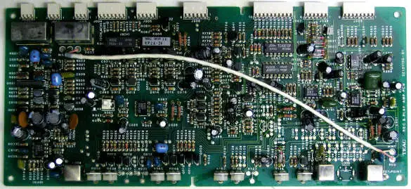

The 58
Here's the 58 rec/play card for reference.
By the way, about the 38... I always thought the 32/34/38 used the same cards, except for a few resistors and caps in the EQ section since the 32/34 are NAB and the 38 is IEC. :confused:
They would have different part numbers, but I thought you could modify one to work in the other.

Oooooo that looks familiar...wait...Tim...Is that a picture of one of my amp cards??
Yeah, the part numbers for the 32 and 38 cards are different, but they are very, very close.
