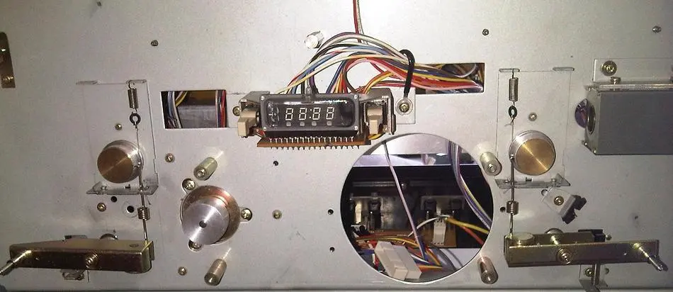

Hello everyone. I am also in the process of restoring a 1987 TEAC-branded (33-2) TASCAM 32. It is all done except for the tension arm functionality - they don't drop properly it seems.

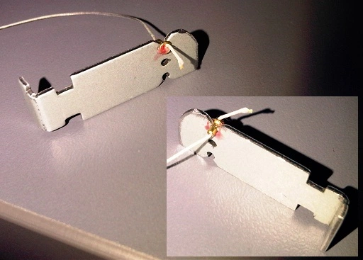

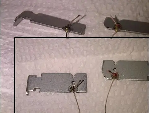

As you can see in my photos below, I reinstalled the ropes to their respective pivot plates by gluing each of their small brass bell-like clip to the underneath of each pivot plate. I did not shorten the original ropes, and the brass bell clips were not moved from their original factory locations on the ropes. I have rewound the rope around the larger aluminum wheel in the deck, and lubed all metal joints with silicone grease.
Alas, the tension arms require quite a bit of pressure to make the rope slide around that aluminum wheel and make the pivot plate drop..... Without this feature, the motors don't stop when the tape runs out. The arms have no problem moving up however, but that does not involve the ropes/pivot plates at all. Perhaps too much rope tension?
Anyone know what may be hindering this? I think it should move quite easily up and down, as per the popular Velvet Dream video "Tascam 32 Tension Arm Behavior" on YouTube. I think they removed the instructions on their website on how to fix this issue, as I cannot i find it anywhere.
Any help would be greatly appreciated!!
