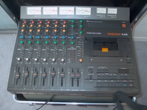

WAIT! Did someone say...
Tascam 246?
WTG, dude! You scored!
I have this little beauty, here! [... and more!]
