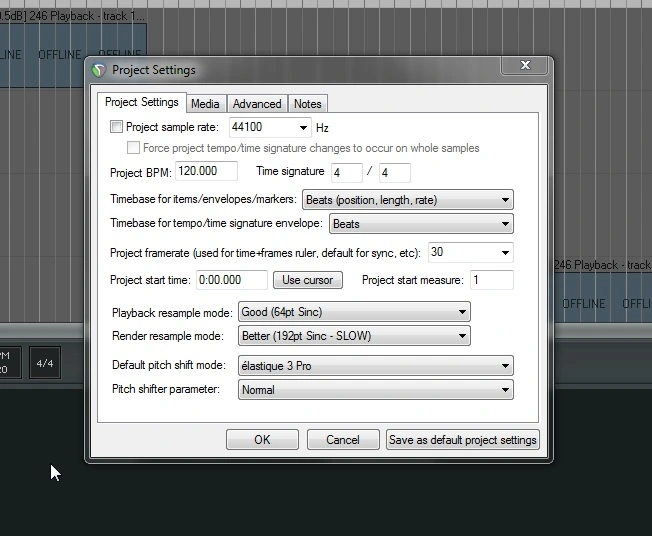

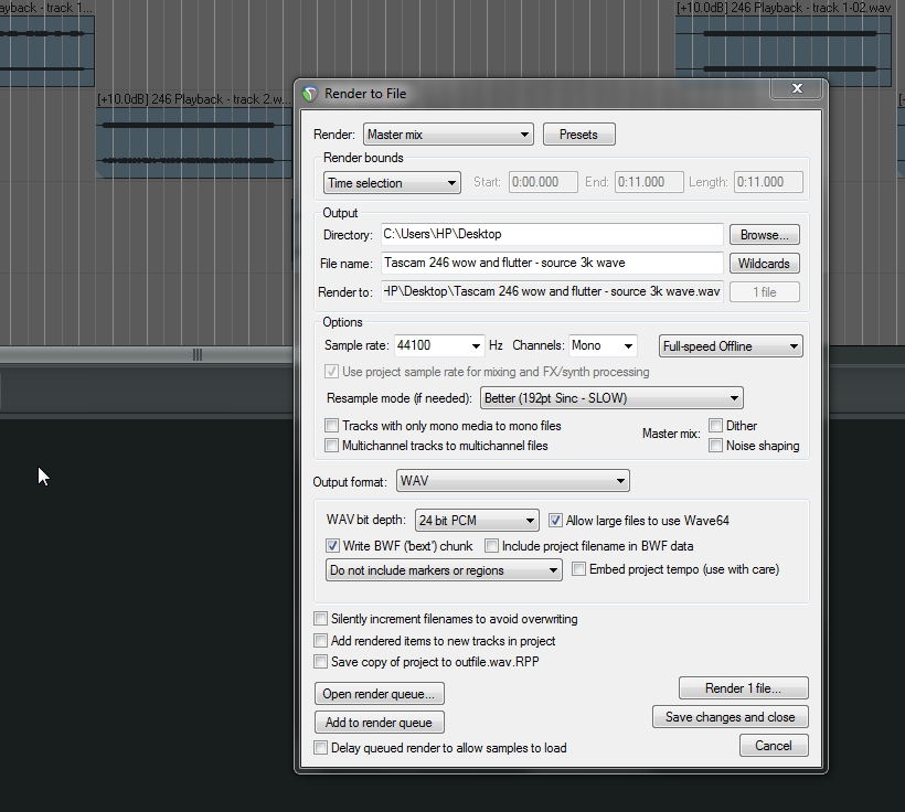

And now I know the reason that the files were showing up the way they were for you. I had converted them to mp3 files in order to post them on this site. So the settings in the converter program must have been that way.
Here’s a link to the new wav files, which should be 44.1k mono (see screenshots in Reaper).
https://www.dropbox.com/sh/5ex8gdrqc13gfh4/AAARe3IaYnjrN6_AM2sxJDhWa?dl=0
P.S. I am getting WFGUI to work for me now, for some reason. I don't know what changed. But I don't know what settings it should be.
