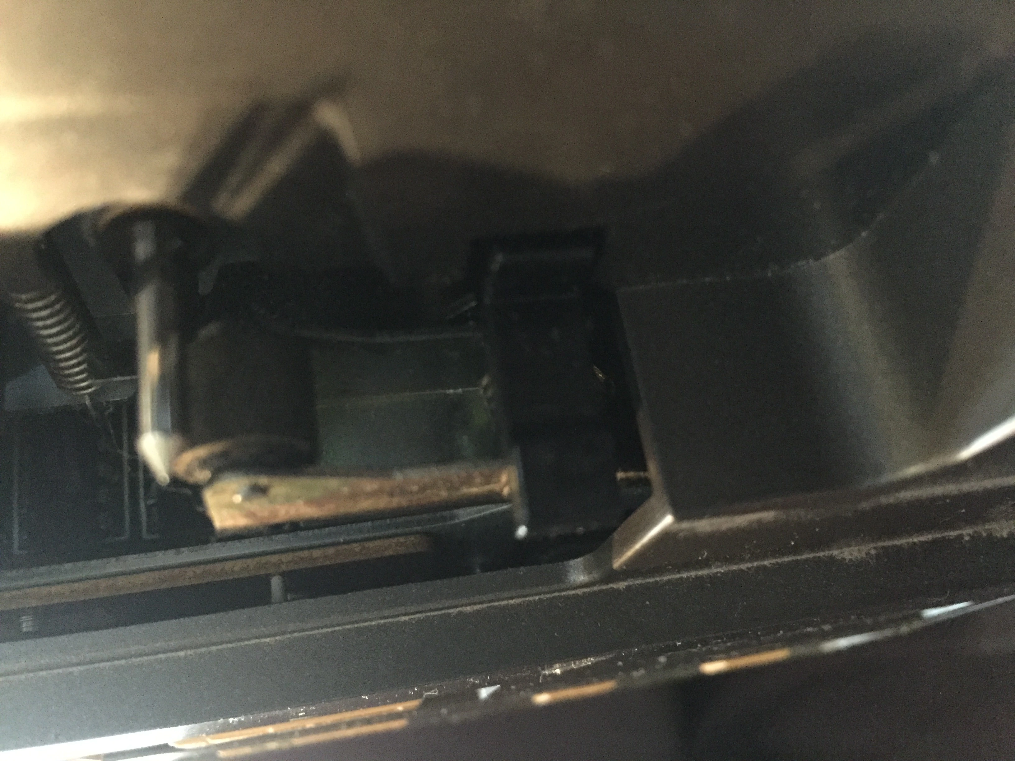

3. I want to make sure I've installed the roller correctly. If you look at this picture of my roller (before it was reconditioned -- it looks brand new now), you can see how the little pin sticking through the roller is sticking up out of the top a little bit. It does not stick out through the bottom like this. In fact, it's not even really all the way flush with the bottom of that gold housing. It's just kind of pushed against the inside of the bottom lip. I couldn't push it through easily, and I didn't want to risk bending anything with pliers or anything, so I didn't push it. It seemed stable, so I just went ahead and installed it like that. But do you know whether or not that pin is supposed to be sticking all the way through both holes in that gold housing? And if so, how did you get it to do that?

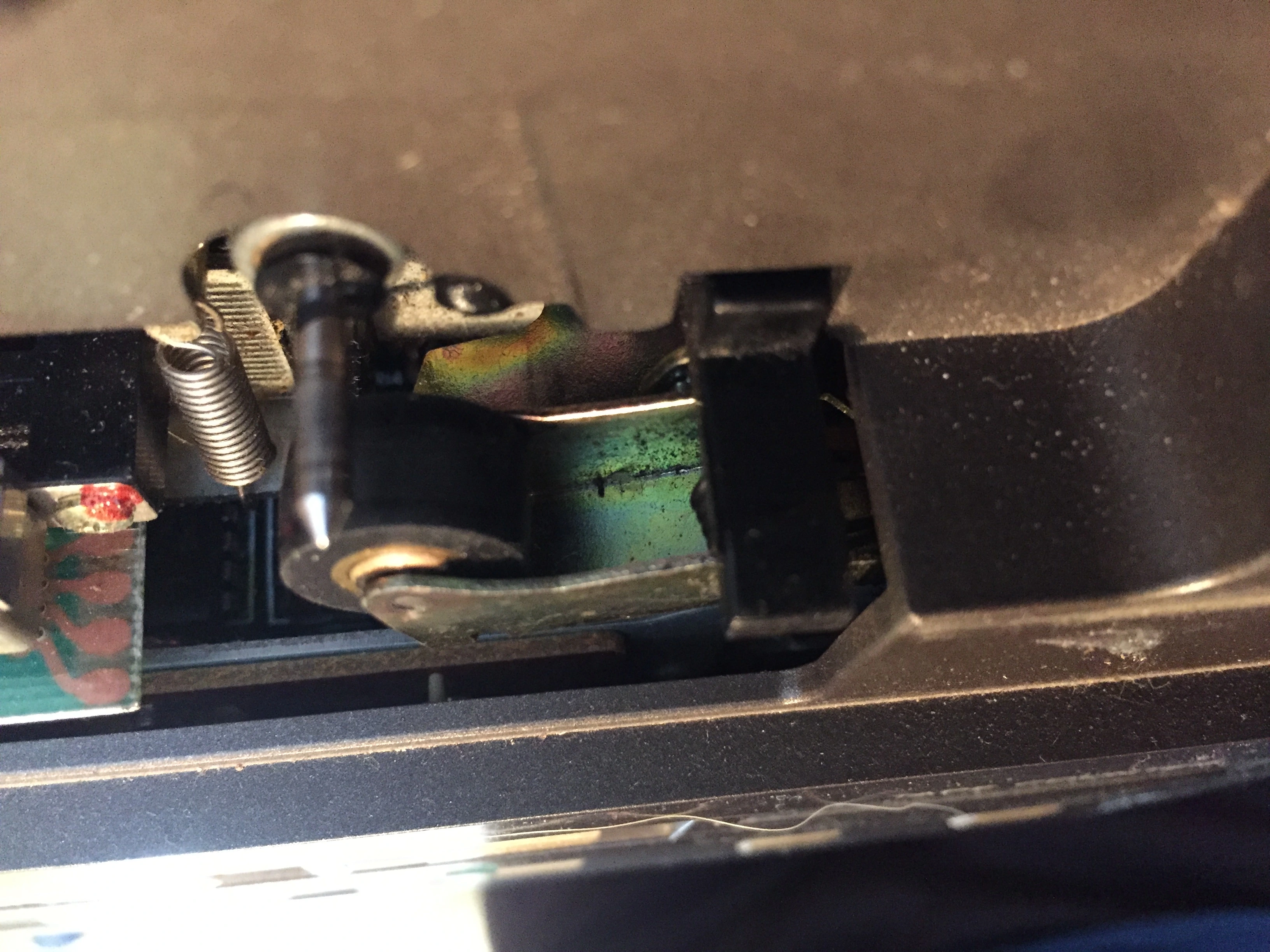

Maybe I can help you on this.... Here is a pic of one I redid... I was really careful to matchup the pin and bracket to how I had took them apart.
This one is below flush with the brackets
This photo is from one that I need to do (it's sticking up)
This one is above
(I know these are upside down, but I'm old and technology is not kind to me.......)
Just fyi
Thanks Brad. So how did you go about getting that one pin flush with the brackets? Did you use a tool?
I believe that one end of the pin is flattened a bit. I made sure I punched the pin out from the bottom (since I wouldn't ever use it upside down).
When I punched it out, I put the pin and hole over a set of vice grips, with the jaws just wider than the pin, and used a nail and a hammer to punch it
On the next one I do, I think I'll do the same, but when I reassemble it, I'll flare each end of the pin better by tapping it with the hammer while the other end is on a hard surface. The flare should make it near flush. Looking at the mechanism, I think there is clearance so the pin doesn't have to be flush on both ends, just captured.
Hmmmm ... ok thanks. I guess I'll open it back up and try reinstalling the roller to make sure the pin is flush with the brackets. I don't know if that could be contributing to the issue, but seeing yours, makes me think it couldn't hurt.
.....actually, this has me a little worried too on the one I did. I might open mine up and flare the pin on the first picture better......
