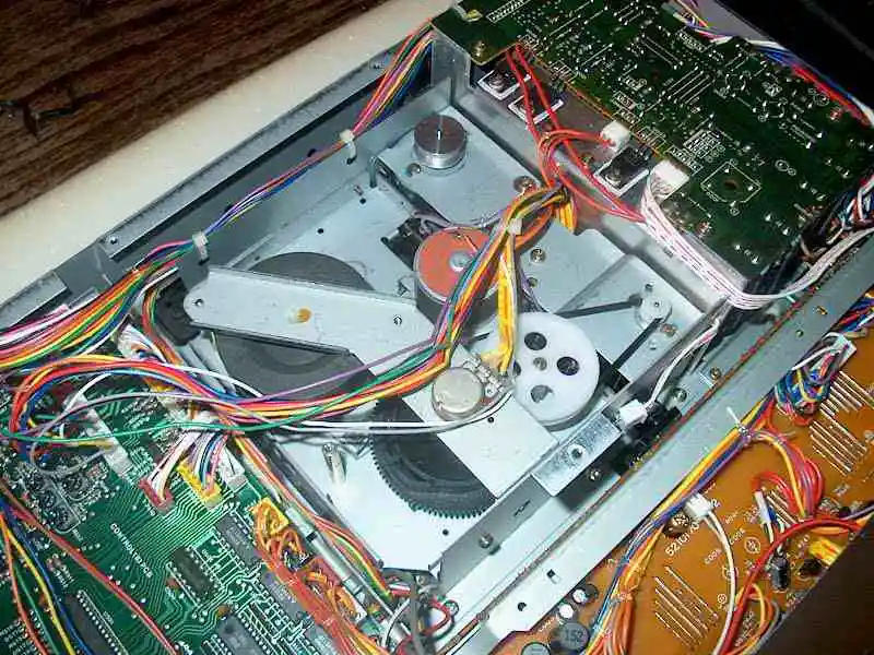

I broke out my 246 to record my daughter's piano practice two weeks ago. Upon playing back the recording the next day, the playback speed was much faster than normal. I had to use the Pitch control to decrease the speed appx. 10% to make it sound normal.
I'd known of this issue before, but here's the textbook case of it!
The capstan belt had stretched and ridden down upon the flange of the capstan motor pulley, causing the speed increase.:eek:;)

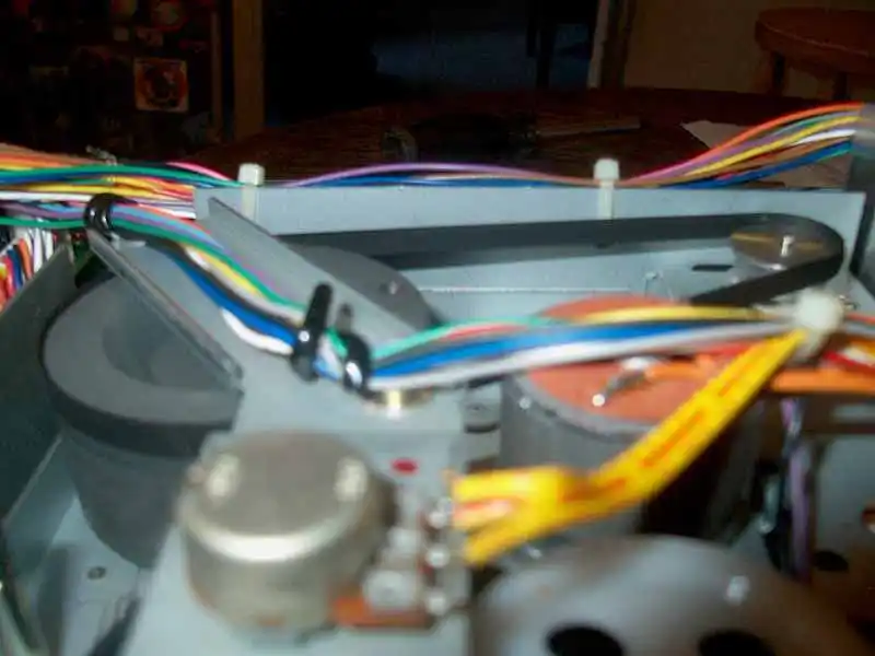

Had to...
Had to remove two screws from the flywheel bracket to loosen it just a bit. There are cable wraps attached to the screws. The bracket does not need to be entirely removed. The capstan belt is removed by sneaking it between the bracket and flywheel.:eek:;)

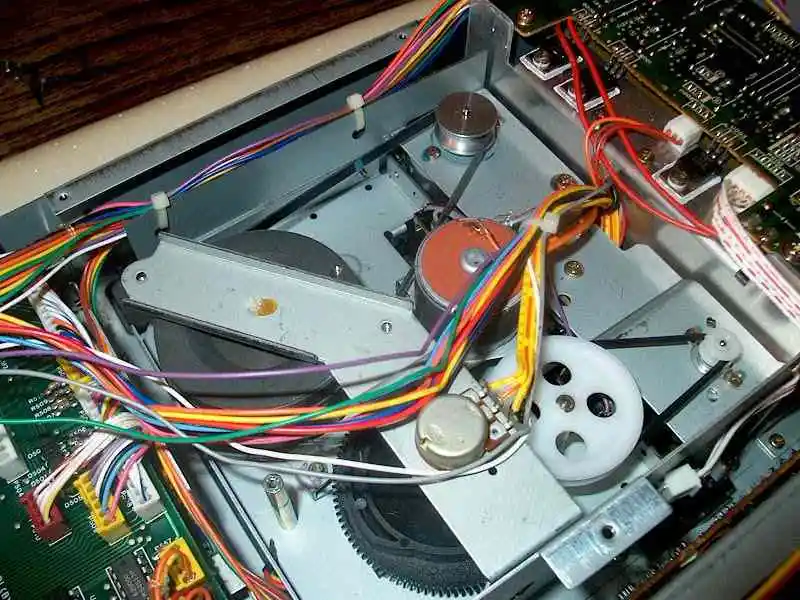

The new 246 capstan belt is 11.5" (PRB FRM 11.5)
An 11.5"~11.7" (total length) replacement belt is adequate, (capstan).
The stretched belt was exactly 12" total length.:eek:;)

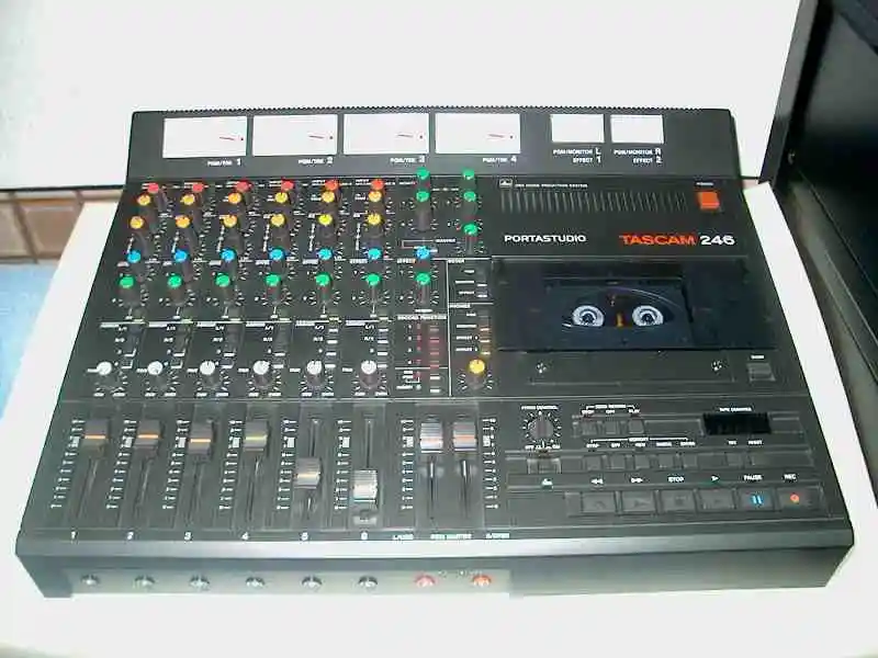

The 246 is exactly like the Tascam 244 cassette mechanism. Eh, ZEE?:eek:;)
The 244 and 246 use the same size belts.
