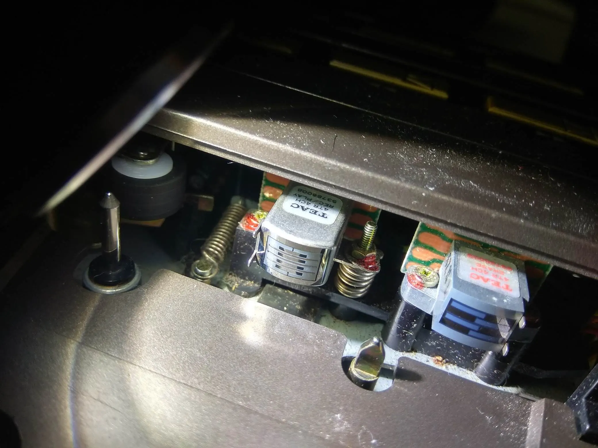

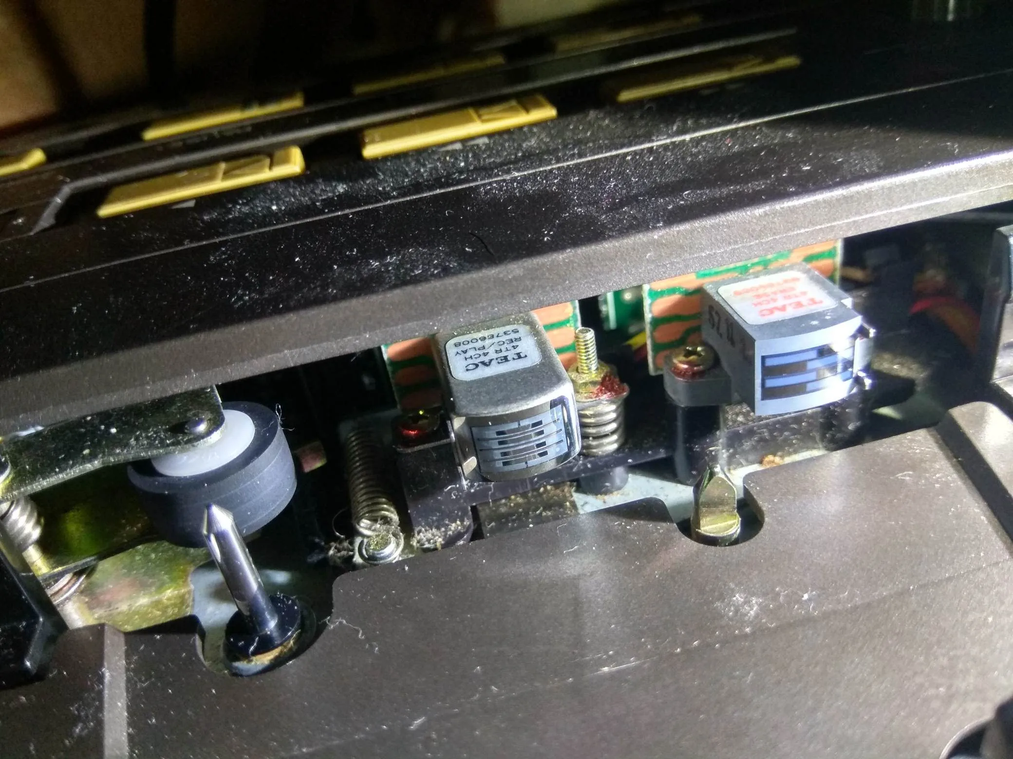

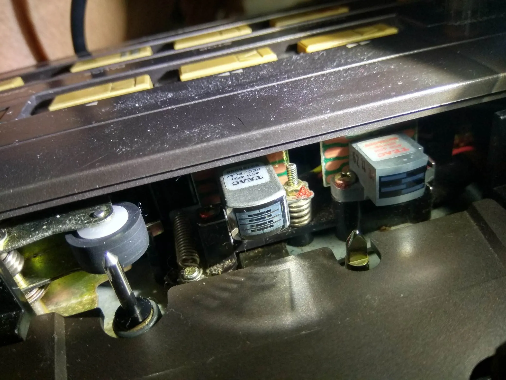

I've attached some pics here, I hope you guys could take a look? Please help! I feel like I'm about to go mad.

The heads look clean. They look fine. I don't think they look worn. Worn heads would not be my first suspicion.
There can be many inconsistencies between cassette cartridges, from one to the other, and some of that depends on the brand of tape.

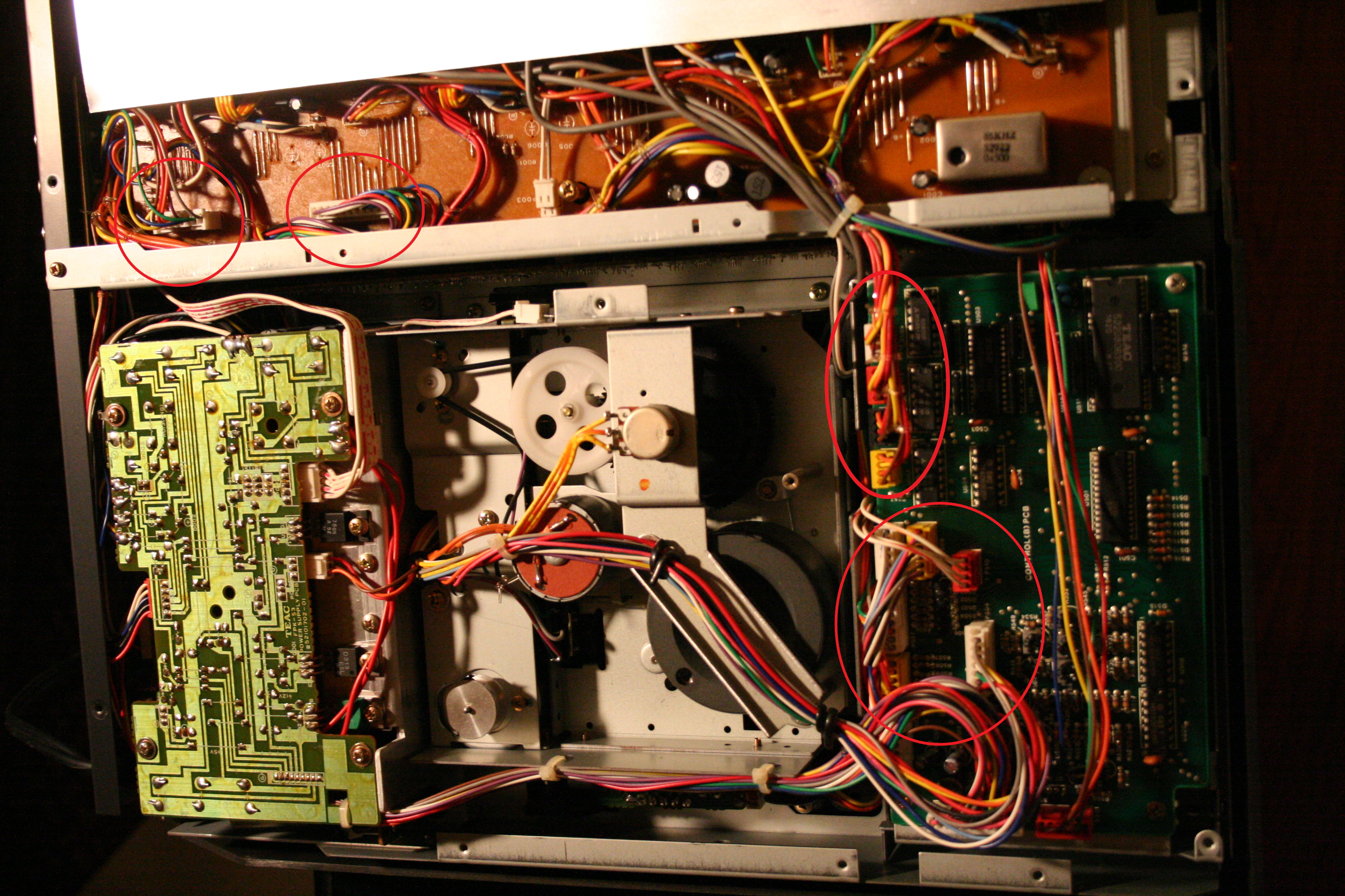

I think it's most likely some corroded connections that need to be reseated and cleaned with contact cleaner. I've had similar issues with more than one four-track recorder, and that's what fixed it on more than one occasion.
Tascam uses a bunch of ribbon connectors in these units, which can be pulled out and plugged back in with your bare hands (or sometimes you may need a small pair of pliers if it's a tight fit). If you're not too afraid, you can open it up and give that a try. Just do it with every one of these connectors you see. (It's very unlikely they all need it, but if you're new to this, then it would take too long to explain which ones need it, and it's not going to hurt anything, assuming you're careful.)
When unplugging the connectors, never pull by the wires. Always grasp the plastic connectors themselves. They should pull straight out. If some are a bit hard to get, they'll usually come by gently rocking them side to side a bit as you pull up.
Once you have them unplugged, spray some contact cleaner (such as De-Oxit) on the terminals and in the connector. Then plug and unplug them a few more times before finally plugging them back in for good.
Do some searching on this forum for the 244 or also on YouTube. I think several people have documented repairs on it, and some of them may tell you exactly how to get inside the unit and what to expect, etc.
See the attached photo for the type of connectors I'm talking about.

It's hard to tell from the pics if the head is worn.If you run your fingernail top to bottom ,is there a lip or visible slot the width of the tape in the head? If you plar back a previously good track,is it bad now? Are you using a new CR02 tape?
Does the 244 use mechanical relays for signal switching?
In order to tell what is really happening you need to put the right signal into the unit per the service manual. Then using Chrome tape like Maxell XL II then evaluate. Yes there are relays in there but I have also caught channel problem due to bad solder joints. I don't think the heads are bad but this looking is not so easy to see- bad heads are usually having a ripple surface as seen with magnification and good light. My shop has new heads for the deck in case it needed them. Lack of good recording could be use of the wrong tape- I get lots of Porta Studios in with Normal tape in them and or could be the garbage 799 type Korean Chrome tape that is 5dB down right off the bat. I always test my units with Maxell XL II and I have no problem calibrating the decks with that. TDK SA or SAX would also be a possibility.
