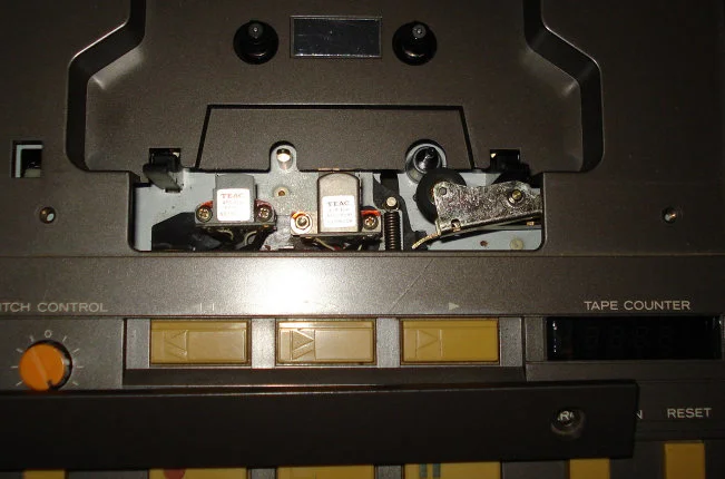

Do any of you guys know, from actually doing this, if it's necessary to pop open the bottom and then the top hood to effectively change the pinch roller OR is it possible to accomplish this task by removing that small panel, just above the transport buttons, held by those 2 strange silver screws? Thanks!:)
Afaic,...
On the 244 it's necessary to remove the cassette mech from the chassis, by opening'er up and removing the mech & flipping'er over. Unfortunately, there's virtually no easy access from the front,... IIRC !!!
The 246 I'm not sure or can't remember.:eek:;)
For more explicit info, you might want to check the DrZEE website.:eek::eek:;)
(I could always be wrong or have faulty memory).
Thanks Dave but are you sure it can't be done by popping the hood open, as I've done here:
https://homerecording.com/bbs/showpost.php?p=3206791&postcount=10
I was just trying to figure out if it can be done another way 'cause as it stands now, I'll have idler tires installed but the pinch roller is good. At some time in the future, though, I will want to replace it too but was hoping I didn't have to open 'er up again.
Daniel, Dave? Didn't we already talk about this? Or am I dreaming?
I don't see how it would be possible to remove the pinch assembly from "its shaft" as the portion of it is covered by the top/face cover (See attached photo). You need to remove the c-clip and slide the assembly straight up), and remember that you'll have to deal with that pain in the neck pressure-spring, especially when putting it all back together. You'd need to remove the bottom and then the top covers ...to get "under the hood" that is :)
