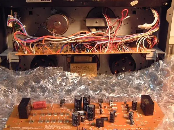

Did you notice the picture where the transformer is, board is split in two pieces.
Poor packing and with the rear plastic panel taking a hit, the first thing that goes is power-supply board:(
Best way to ship a 22-2 or 22-4 is standing up inside the box + alot of wrapping and support around.
Found a picture of the last one I fixed, notice the brackets on each side attached to the frame, that's the problem :(
