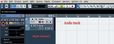

Now, create a track to record to. Project>Add Track>Audio>Mono.
In the 'Inspector' window at the left of the main project window, look for a symbol that looks kinda like this: >] SEE ATTACHMENT
This is where you select the bus you created in VST Connections. You will change this on each track that is using a different input channel on the 1800.
If you don't see
the symbol, click on the track name at the top of the Inspector window to pull to the main Inspector screen.
