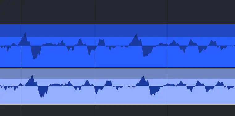

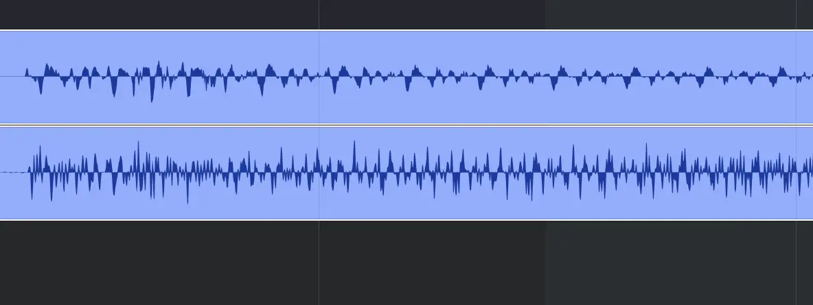

There are no phase issues whatsoever. If it's double tracked, the waveforms are entirely different and there can't be any issues with phase. Even with the same guitar, same distortion pedal and same amp (sim), but played twice. In fact: you can take the same DI guitar track, run it through two different amp (sims) and they will have entirely different waveforms. Phase issues only occur when copying tracks, or when you use multi mic setups. Or of course running the exact same signal through different devices and one has - polarity while the other has +.
Two identical tracks, quite out of phase. They are clearly the same, but shifted a few ms:
Same DI track, ran through two different amps and mics (but with a similar sound): the waves are significantly different and there can't be any phase issues.
