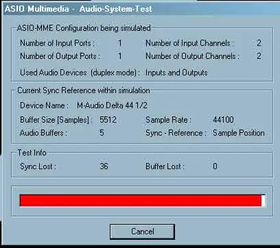

Edit: Can no one help? When i check the synch on the ASIO miltimedia setup, the input ports pass, the output ones fail badly. Why would this be i thought the 44 was good for stuff like this?

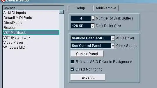

Included is a screenshot, i've tried increasing the buffer size manually all the way to the maximum, it makes no differance.

Found a setting in cubase that wasn't set to m-audio asio, shown in the screenie. Cant say whether or not its stopped the audio non synching but it hasn't stopped the delta failing the synch test.

Try it with the setting set to ASIO. Dont worry about the asio tests, you really dont need them for anything, the Maudio Delta drivers are solid
