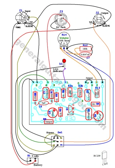

Tracing through the "schematic" that I got from GGG, it appears that all of my connections are made in the right places, soldering is shiny and clean (much better looking than the first pedal I built that actually works) and I'm running out of ways to check what's wrong (until audio probe is complete).

Build sheet can be seen here, it's a pdf.

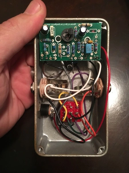

And, here are some pics...

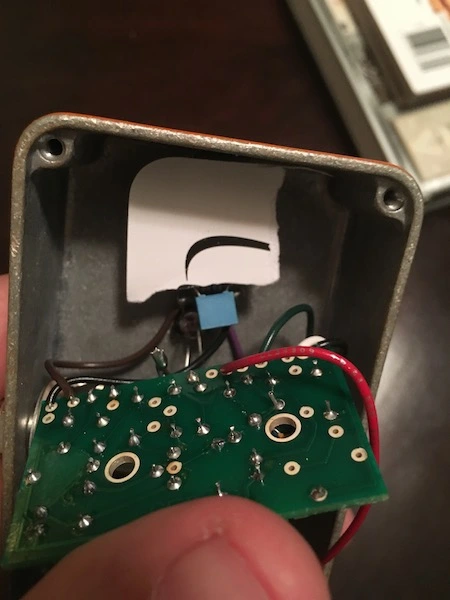

This one shows the rigged up pot cover - a piece of cardboard to keep the solder joints from making connections with the pot. I got this kit with a small enclosure and there's not any good way to make use of the standoffs they send. I'm worried about this because I powered it up and tried it before I even thought of putting any kind of non-conductive materials between the board and the pot - I'm sure that any and all of the solder joints in the vicinity of the pot were touching when it was powered up. Hopefully nothing got shorted and fried but the audio probe will probably be the only way to figure that out.
This is a decent view of the board - all resistors/capacitors were triple checked for values and functionality prior to installing.

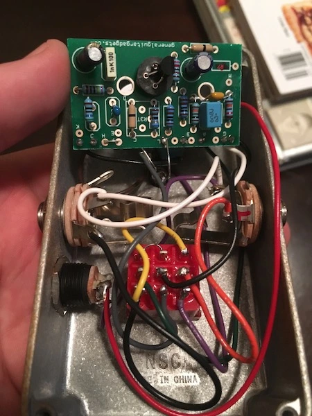

This is just an alternate view of the board and layout internally. Again, the wires look like a jumbled mess...I had them tucked away nicely when I put it all together but in my troubleshooting they have all just been pulled out of place.

No worries. Does the LED come on? If not, test the soldered points on the DC jack with your meter for 9V, noting polarity.
Maybe the picture isn't showing it well but it looks like the solder's pretty heavy there. Maybe they're bridged?
If you're worried that something got shorted and fried during your first test, the transistor would probably be the first thing to check.

Something else that took my eye. The base leg of Q1 has two traces meeting at it - You've soldered to one of them.
Is there continuity between these two points. It's hard to tell from the photo and the schematic.

Ok. Try to understand the switch fully before proceeding.
The orientation in your pictures is the same as in the schematic, so that's handy.
The switch takes the middle row of pins and sends them all to the top row, or the bottom row.
In the bypass position the middle row is tied to the top row.
Pedal input (Green) get's grounded to the black beside it, via that jumper on the top row.
Your guitar input (bottom left) isn't sent anywhere by the switch, hence that yellow bridging wire.
That arrives at top right which, because of the switch, is sent straight to output tip orange.
In the ON position the middle row is tied to the bottom row.
Pedal input green is tied to guitar input, so you should be getting GTR to the board. That yellow bridging wire does nothing now.
The jumper above them is connected to nothing.
The LED gnd pin is connected to ground on bottom row,
and the pot wiper blue, which is your board output, is tied to orange, output jack tip.

Basically, the switch should either send your input signal to Green (on) or Orange (off)
