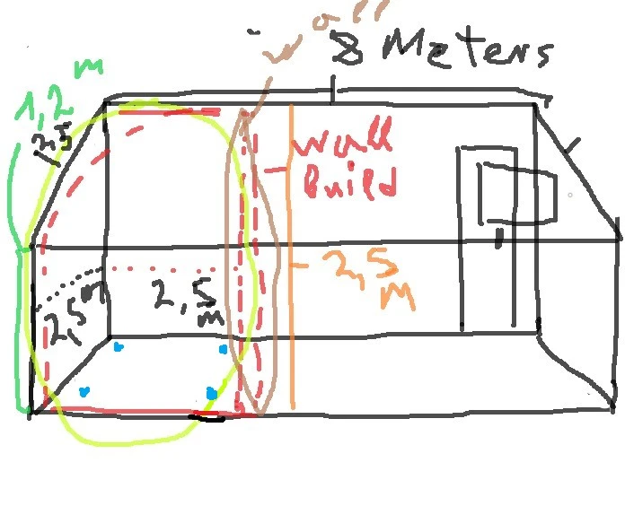

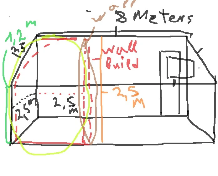

Hi all,
I have a question to build my new studio room.
How u can see the walls are not equal and the room has not squared form.
So I decided to build a wall inside the room to make it more squared form.
In yellow and red u can see the where the studio room will be placed.
But my upper wall is falling down in triangle form.
I will not have it hard to build that wall. But my question is....
On which side is better to put the studio speakers? on the higher walls or on the lower walls?
I marked them with blue dots
10x in advance !

Why are you building a wall to make two very small rooms?
Why not just use the whole room...no wall?
In that 2.5m x 2.5m room...it won't make much difference what wall you put the speakers on.
Square, small rooms are NOT good.
Don't add the wall...use the whole room, and then put your speakers on the lower wall....in the middle of the wall.
What [MENTION=94267]miroslav[/MENTION] said. A rectangular room is better than a square room.

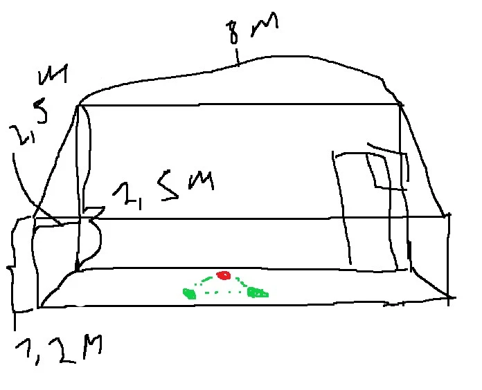

So I made the hearing spot here and the speakers triangle.
But how u can see the room is very specific and not everywhere symetric.
Don't look at the things inside. They will not stay in the studio. It is all about a clean room without anything.
What u suggest in the second situation? Will be a problem if the hearing spot is in the middle ? I can cover with more acoustics

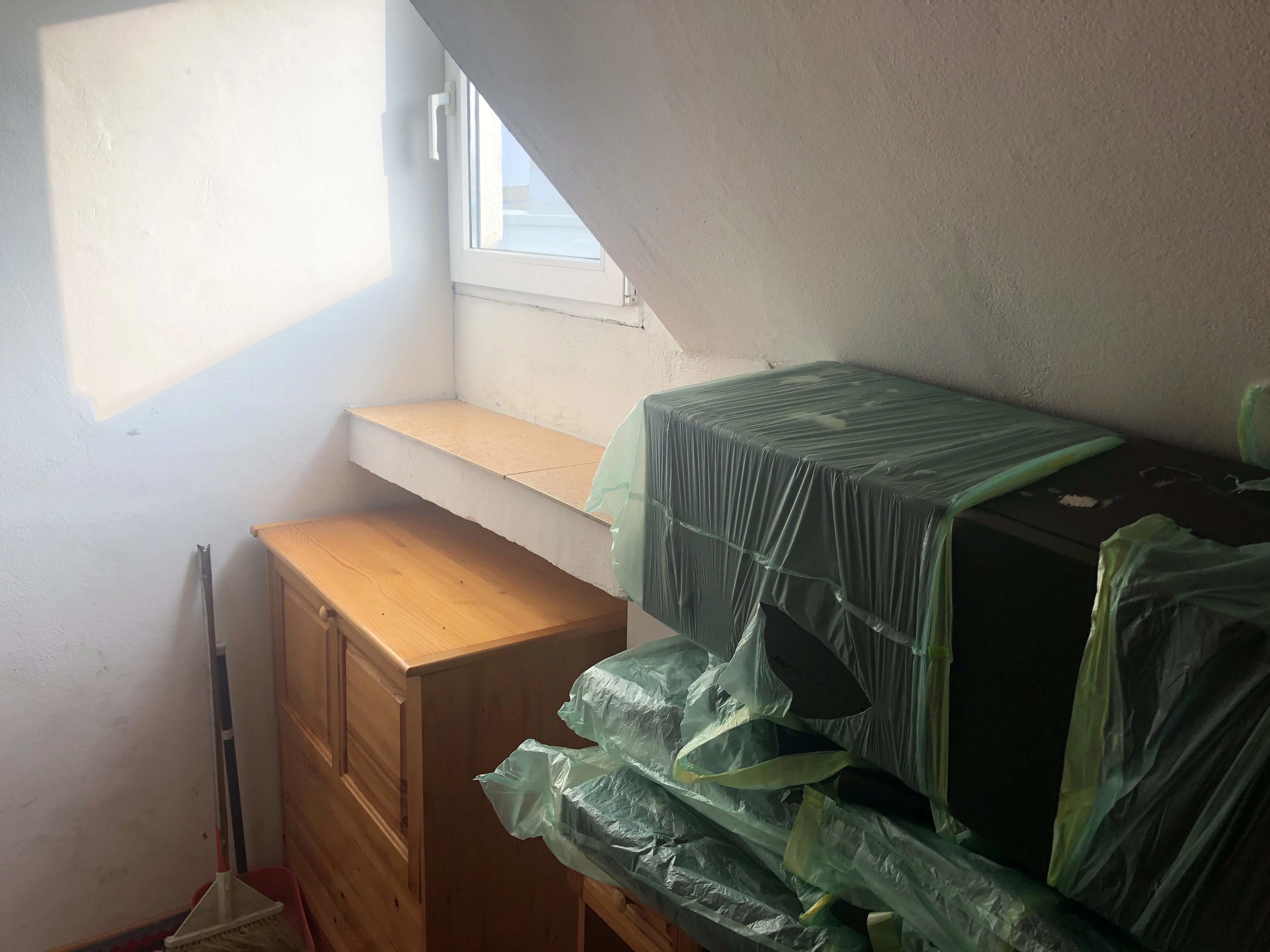

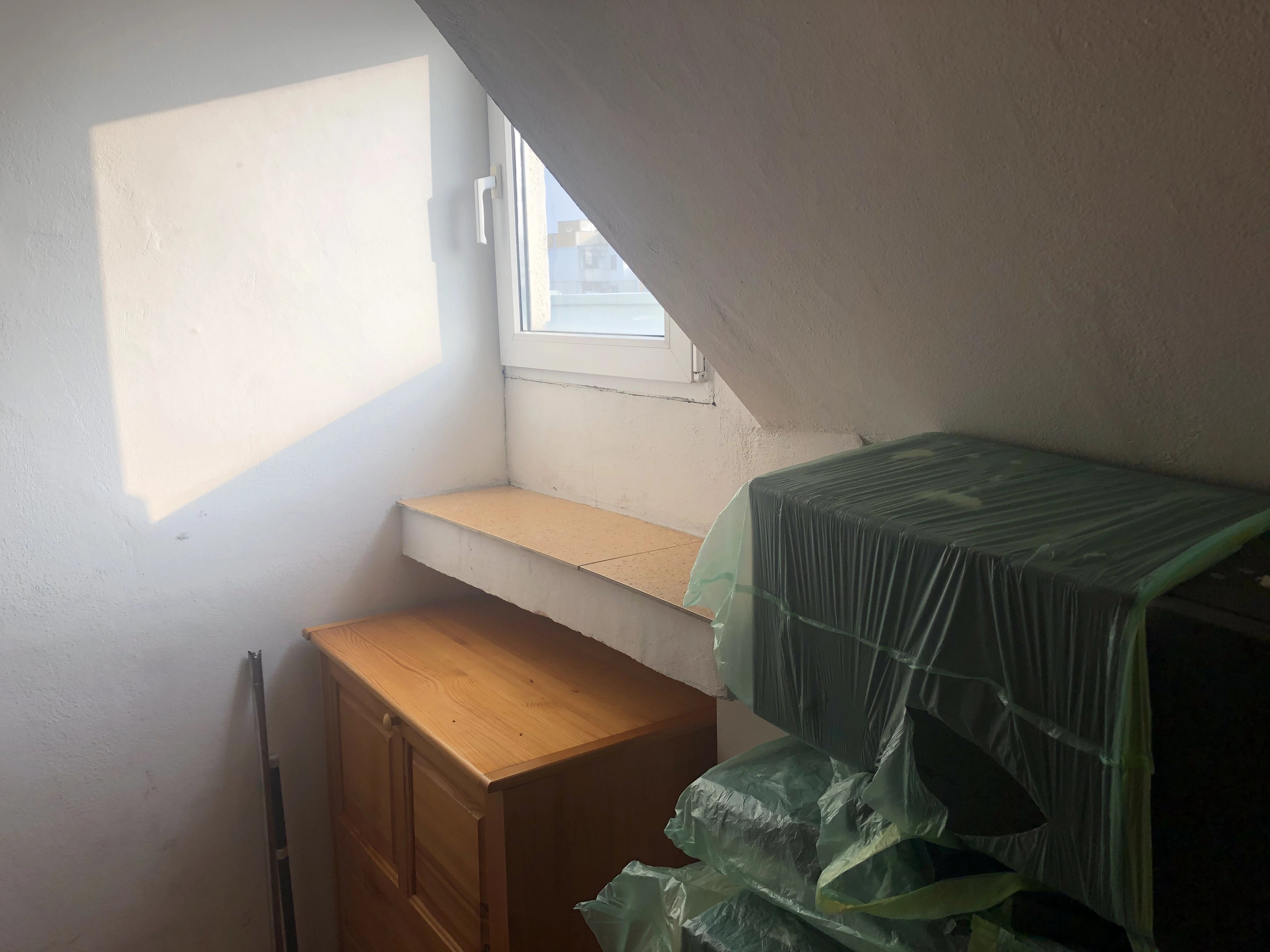

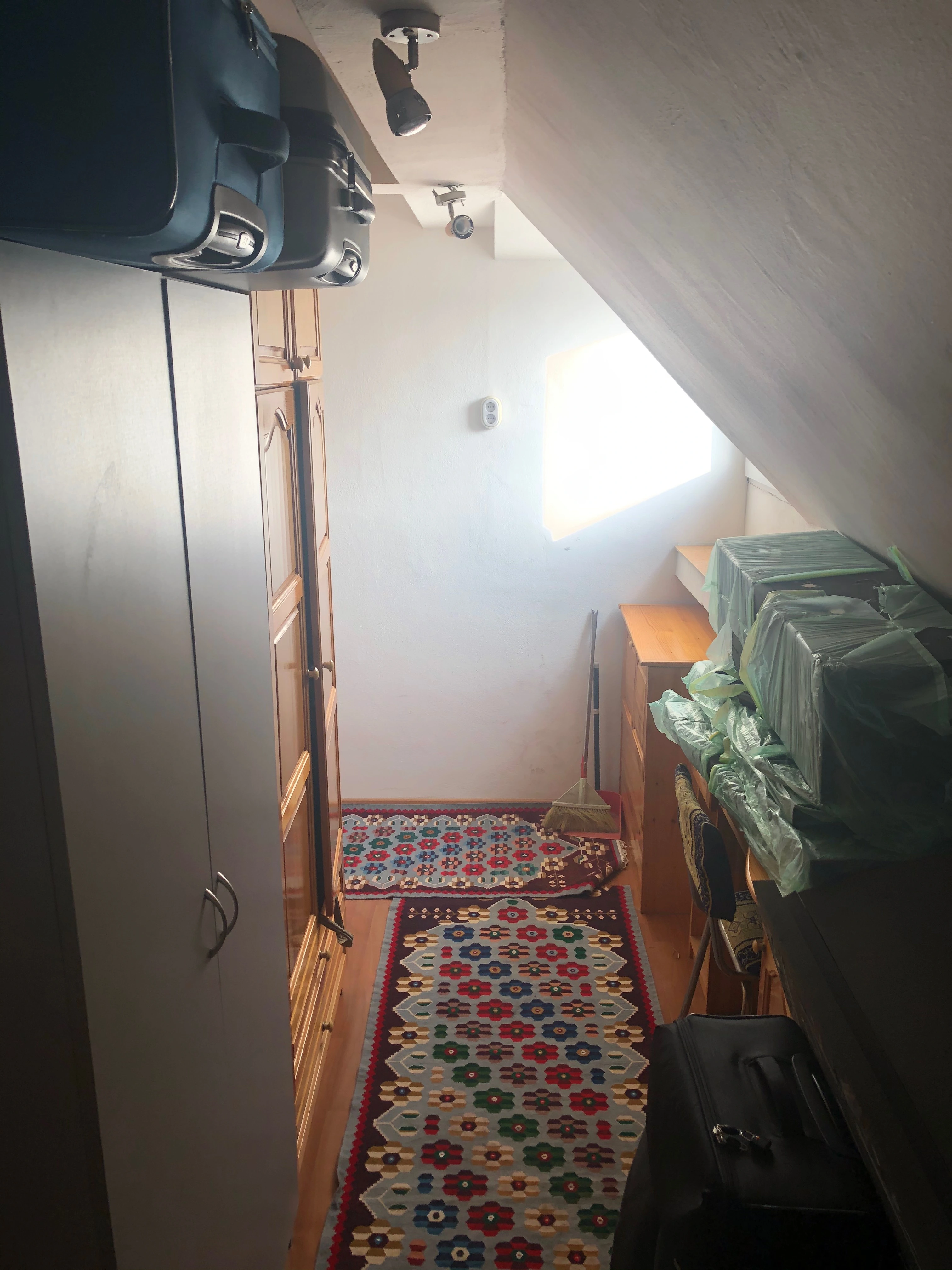

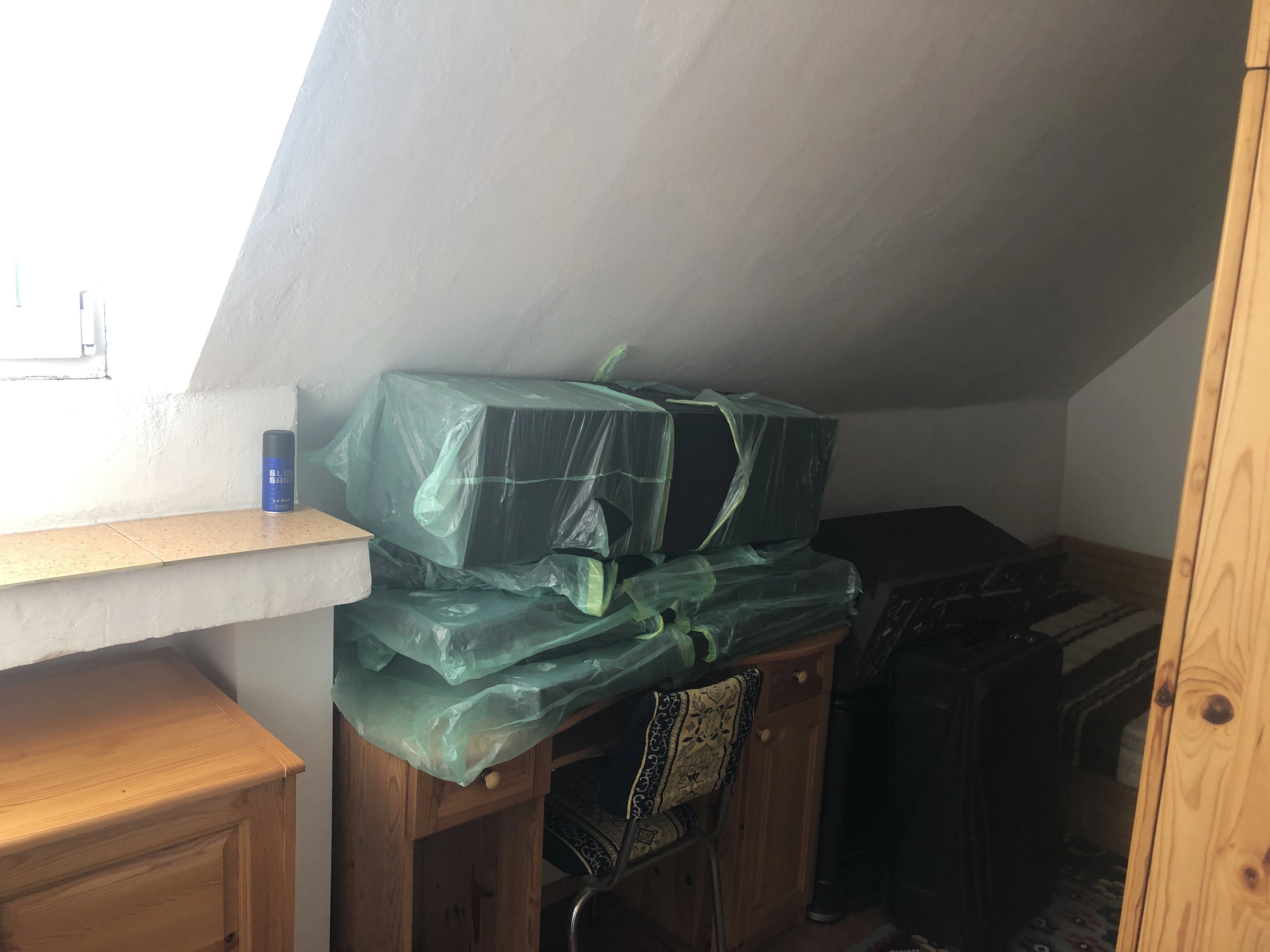

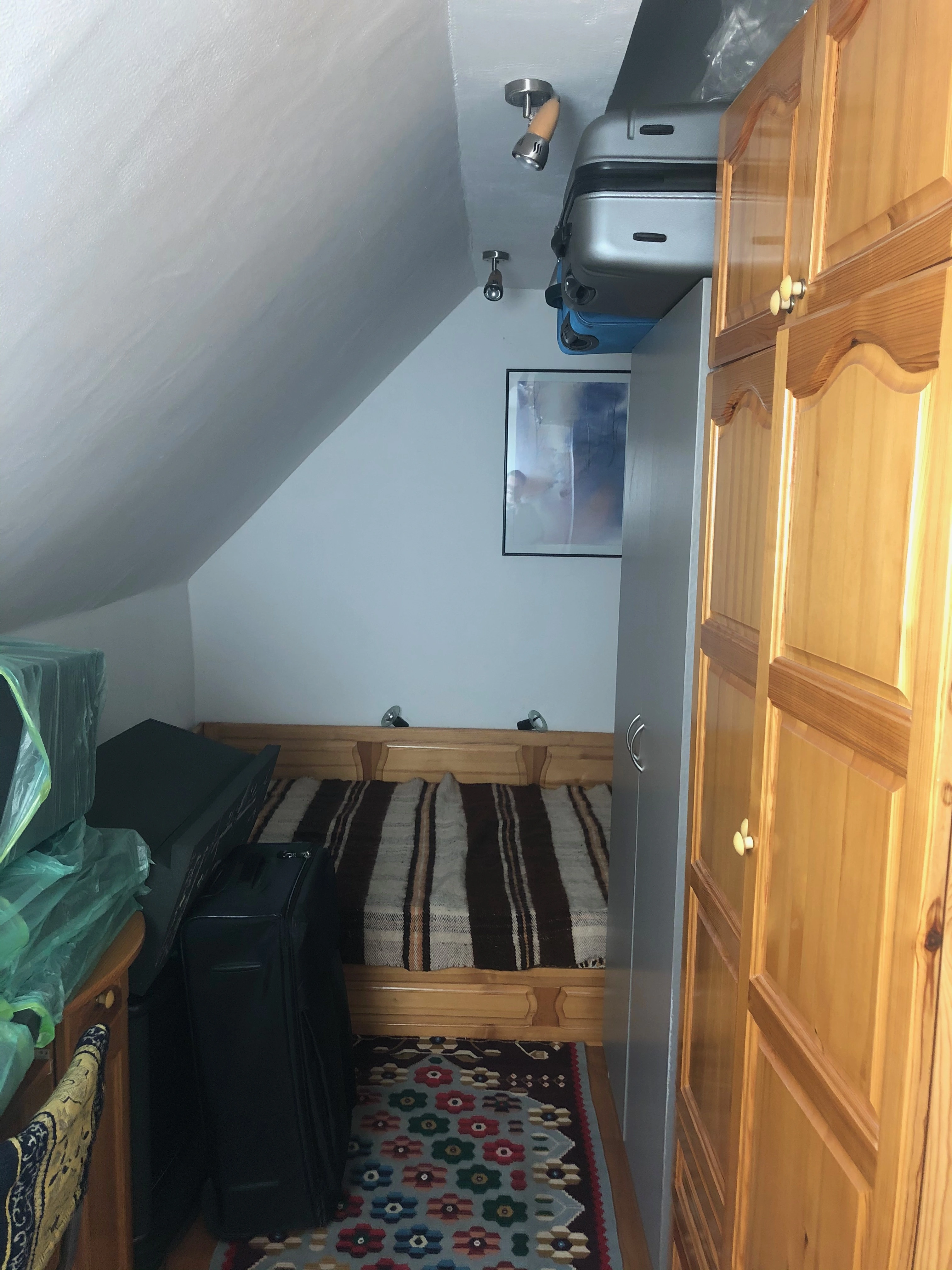

Good luck...that's a tough room for music. Way too small and awful angles to deal with.
Just saying it how it is. So make the best of it if that's all you have.
It really won't matter much where you put the speakers, but certainly you will need a good deal of broadband & LF absorption.
Make it is as dead as you can...it will sound like a bigger space then.

Oks well, should I start to build my home studio in that room or not ? Will it be fine if I cover all angles with some traps and insert some panels ? In case I put the hearing spot in the middle ?
Like I said...use the room that feels the most comfortable to you...then add as much traps (panels) as you can...and that's going to be it.
There's really not a lot you can do differently...or that will make some dramatic difference...so pick the room that feels better to you for recording.

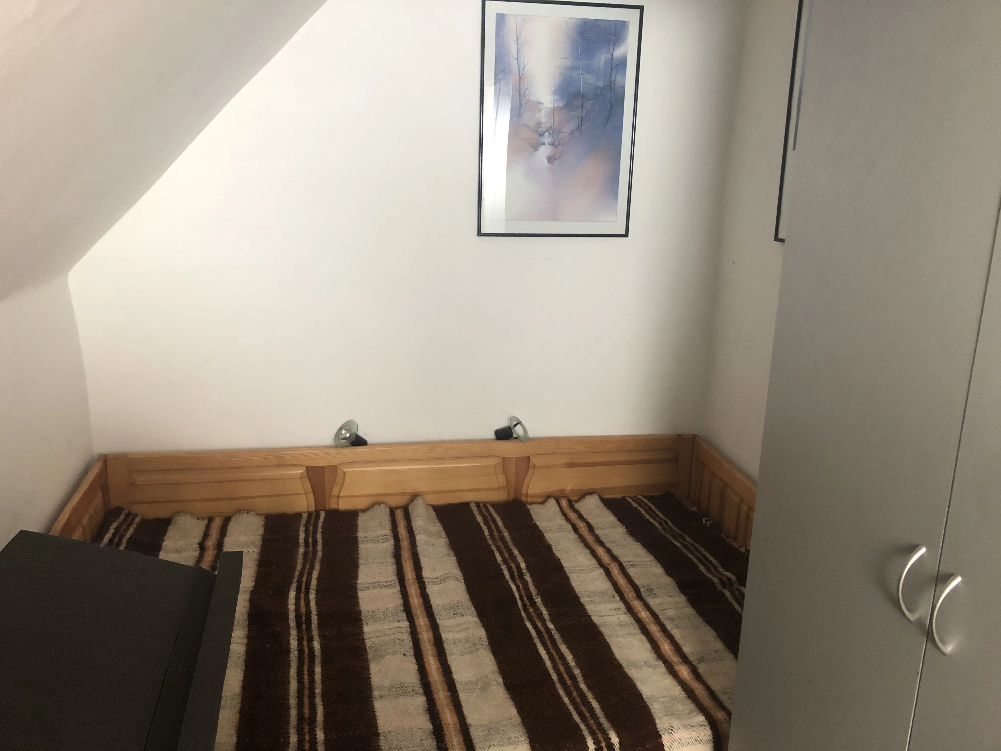

The problem is I don't have much choice for now may be for the next 2-3 years. OR I must make my bedroom to studio :) it is good for recording. :) has rectangle form near to square. But if I do this in my bedroom I will get killed :). I don't care about the comfortableness of the room. I am only collecting information to build the things right as much as possible...

Everything [MENTION=94267]miroslav[/MENTION] has said - the room is an unusual shape and small.
Making it smaller is only going to make it worse.
That's a lot, even too much, monitor capacity for the size of the room, so you will especially have to be careful with how much you use that subwoofer, or if it's even necessary.
Because of its shape, you will likely have to set up your nearfield monitors against the taller wall in the middle. The one advantage the length gives you is that early reflections from the side are a non-issue, but the narrow width means you'll be hearing the reflections from behind you quite a lot. I would try to apply a broadband trapping across that entire angled ceiling. Not foam of any kind, but something very dense so it doesn't have to be too thick, as the height of that space is very limited already. Then treat the tall and short walls, perhaps using some alternating panels if it's starting to feel too tight. Good panels will be re-usable in any future space. Look into building your own to keep the cost down - it adds up!
I'd stick something that acts as a diffuser on the ends - your equipment racks, bookcases, etc. might be enough. That long dimension is near subsonic wavelength, so unless you're putting that in (and not high-passing any unwanted that sneaks in), those might escape treatment (IMO).

What I'm saying is use either the bedroom or this room, which ever works better for you (more comfortable)...it's your choice...and don't convert either to a small square space, just leave the whole room.
You are not going to build anything "right as much as possible) that will make any real difference in either room.
Both rooms will need a bunch of acoustic treatment...so pick the room that works better for you. It sounds like the bedroom is better for recording, but you :will get killed" (not sure what you mean by that)...so then use the other room...just forget that "square/wall" stuff.
