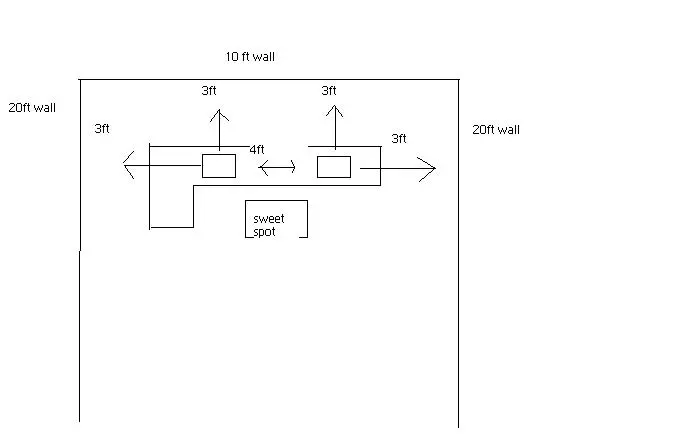

What I would do,...even though it is an L shaped desk, is move it into the center of the 10 foot wall, keeping your monitors equal distance from the 20 ft walls on either side
(so lets say you're sitting in your mixing position, and your monitors are 4 feet apart from each other...that means they'd both be 3 feet away from the walls to the L & R)
Then I would move the desk away from the 10ft wall until your monitors are 3 ft away from it (so...3ft away from the 10ft wall...and both 3ft away from the 20 ft wall)
These numbers are just fro examples sake...and really depend on how far apart they are from each other when you're sitting in your mixing position...aka...the sweet spot.
I attached a REALLY shitty diagram that'll confuse you more..lol.
Hope it helps a little

ahhhh i see what your sayin..........equal distance from the walls (on the sides, as well as the rear wall)......
ok, then thats what ill do.
.....my wife is gonna walk into the room and be like " WHAT THE FU*K ARE YOU DOING! WHY IS THE DESK IN THE MIDDLE OF THE ROOM!!!!........"
(oh well, she will get over it):p
lol..
but NOT in the middle...gotta make that clear...you want it symetrical on 3 sides but not in the middle of the room.
