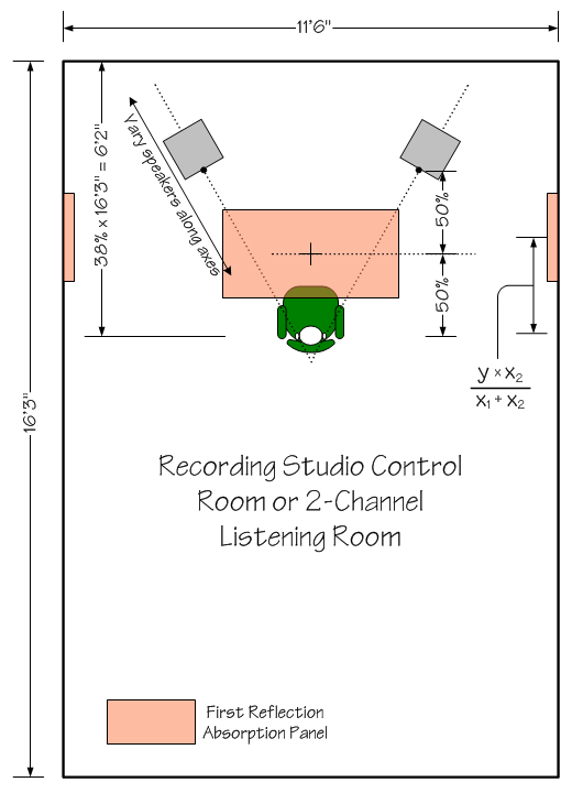

The shape of the room is simliar to the one in this diagram I found from another thread. Mine however is 10.125' wide and 11.75' long.
1) The only piece of furniture in this home studio other than the desk and chair will be one of those papasan chairs. It will be down in the bottom right corner if referencing the picture above. Will one of these chairs be good for absorbing bottom end frequencies for that corner, or should I still go ahead and use some traps behind the chair in that corner???
2) Again, if referencing the picture of the studio layout at the top of this post, between where my two speakers will be, there is a 42" wide window. I am trying to figure out what to do over that window. I'm pretty sure the best thing for speaker placement is to put them just to the sides of the window, but no further than that to avoid putting thme right in the corners of the room. then directly behind the speakers, I'm putting a few square feet of 2" foam. Other than that, should I plug the window and cover it in 1" or 2" absorbers, or should I build a quadratic diffuser to cover the window and fill the space between the speakers???

3) My last question for now is what to do with the wall on the opposite side of the room as my speakers. Obviously I will be bass trapping the corners, but in the middle of that back wall will I be better off putting up foam absorbers or a diffuser or both??? Sorry too be such a noob, but I would rather try to do this decently the first try as opposed to spending a bunch of time and money only to end up with junked room. Thanks guys.
