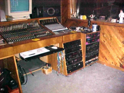

I've built a couple for my stuff. I'd make it out of 3/4" plywood rather than 1/2". Also the rack rails you use will dictate the inside demensions of anything you plan to mount 19" gear. Here's the first one a built.

This what I have now.

Nice desk microslav.

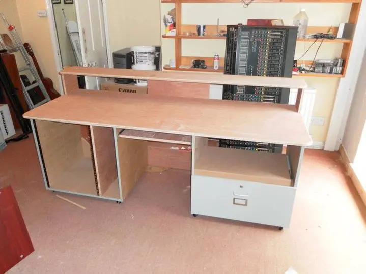

So... here it is:
I made it today. It just needs staining and painting now. I should have that done in the next day or two.
