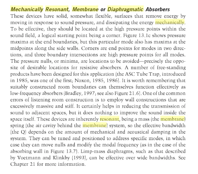

As I understand it, sound absorbers work on particle VELOCITY not pressure and at a rigid interface, aka "wall" the particle is necessarily zero so any absorbent material AT the wall is doing next to sweet FA.
You could of course just make the absorber deeper and touching the wall but that would be largely a waste of material. The gap gives you about the same performance but with less material. Or, looked at another way, about the same performance with less absorbent.
You need traps that work with pressure(high pressure equals zero particle velocity) in the corners.
Foam works with particle velocity transferring to heat.
