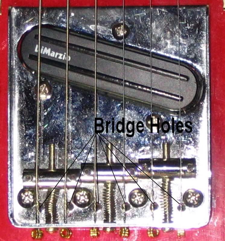

I did a few string through Teles lately and thought I'd send a few pictures of what worked for me. I got my brother in law to help me with his drill press-four hands is much better to steady the guitar body!
Here are the bridge holes from the top:
https://i96.photobucket.com/albums/l161/Anfontan/BridgeHoles-1.jpg
Here are the ferrule holes and the drill bit sizes:
https://i96.photobucket.com/albums/l161/Anfontan/FerruleHoles-1.jpg

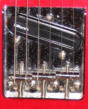

Okay-updated picture of bridge-

Damn, I can't get the pics to load! :mad:
I will try on a different pc later. I really wanted to see this...

Hey Punkin, the white guitar had a bridge that could be used as a top loading or as a through body stringing, it was drilling them correctly thats the trick. Then red one was set up as top loading only so I took measurements from the other bridge to get the holes marked right. A center punch marked the metal after the bridge was removed and 6 holes were drilled.

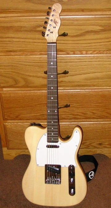

Oh, and the twins are now triplets!
Clear coat finish.

Anfontan said:
Ha Ha...I know how you are-so nothing will surprise me at all~
Clear coat finish.
Ohhhhhhhhhhh.....that is one purty lady Tony...name? Naked Lady? :eek: :D :D :D :D
