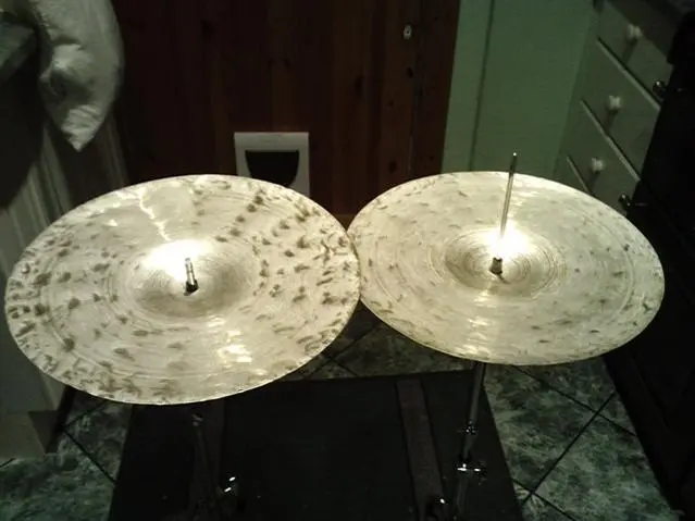

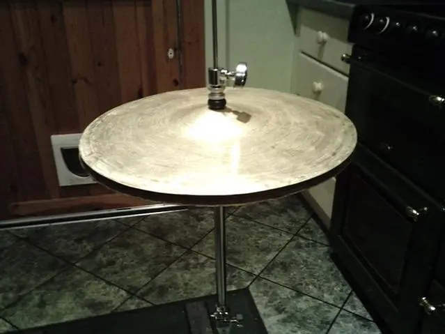

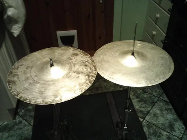

I've just had a go at hammering, oh the fun, and it has worked. They don't pop inside-out, no matter how hard i stamp on the hihat pedal. They don't sound very good, but they never did anyway, and look pretty shit now.
What do you guys think of sanding them? I've seen a company "amedia" sanding cymbals on youtube. I don't have a lathe, but do have a rotary sander.
Fuck it! I'll give it a go, and let you know how it turns out.
Alright guys. Gave it a go and I think it went well. They look a hell of a lot better, and sound a little bit better too.
They still look and sound pretty shit but it's better and they don't turn inside-out anymore, which was the main problem.
Here's the finished result:
MP3 recorded with my phone. Don't judge based on good hihats but on really shitty ones, that come with beginner kits, which flip inside-out.
